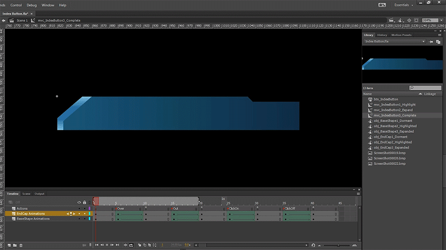

I've been working on this button for a few days. This is my first project in Animate, and I am still trying to wrap my brain around timelines, instances, symbols, and ActionScript. I've created the various elements of the button and their animations, and here is the cycle for the mouse over "highlight" sequence:
It may be hard to make out so I will explain the cycle. There are two layers in the movie clip symbol mvc_IndexButton3_Combined, one for the BaseShape and one for the EndCap. I created a shape tween for both shapes to change their colours and to expand the End Cap inwards, and labelled the first frame on that tween "Over". Then I copied the tween animation and reversed the frames. I labelled the first frame of that tween "Out".
I have been trying to create "smart cursor on/off" effects, so that if the user takes the mouse cursor off the button while it is partway through the animation, the animation will reverse from whatever the current frame is back to what appears to be the initial state (but is actually the end of the reversed animation on frame 20). It seemed impossible to do this with a button symbol, so I am trying to make the movie clip act like a button with ActionScript code. These are all the things I have gleaned from other tutorials to get this far.
So back on the main timeline, I have applied an ActionScript to frame 1 to make this happen, but I am getting an output error:

How do I properly execute this script?
Correct answer kglad
currentframe should be currentFrame.

July 14, 2019
