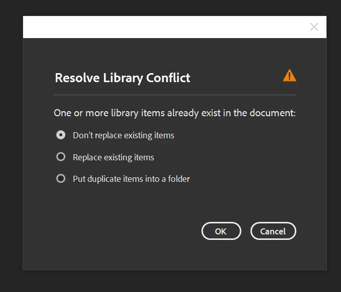

what is the ActionScript solution for "resolve library confict" dialog box in as3 code
  • October 29, 2023
  • 371 views
this is a extension   of the  post " How do make animate cc assemble a avatar in memory - Adobe Community - 14189269" but we didn't quite hit the solutton i was looking for., so so  close but we  hit the
same stopping point  i did!

SOlutions tried so far:
in my flash books ive found solutions for getting for instance a item off the stage by as3 , but not how to you "remove and clear" the as3 name so the new files can come in(the files all have the same as3 name fo each piece, thats how they are combining on the stage under "name"
.  keep in mind this old old dead games files are extensive and simply renaming the as3 names isn't likely to work. i also think this was using the as3 flex loader as that had a option to load a single symbol from a swf if im not mistaken.

kglad
October 29, 2023
tick put duplicates into a folder if they are different but have the same name
October 29, 2023
