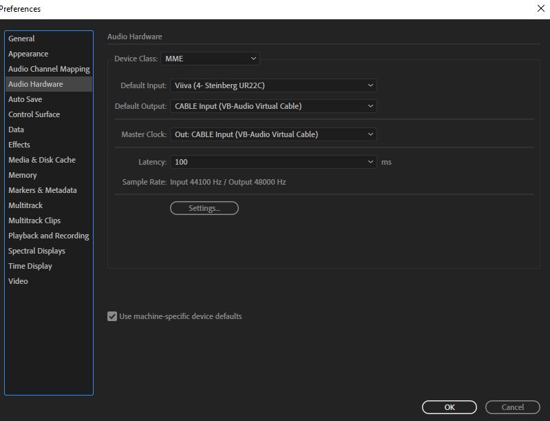

Yes, of course! I put a .wav test sound how the mic sounds after 2 hours of usage.
Here are my some Adobe Settings photos if they help any on the situation.

I updated the settings by eliminating Adaptive Noise Reduction and removing all the extra features that I did not use, only leaving 4 enhancers on (see the image) and it does still make the same buzzing sound. Anything else that comes to mind to fix this?

I was under the impression that the UR22C was updating by itself as the days went by , but I was naiive to think this way. You were absolutely correct on this, it was the UR22C drivers that were out of date that caused the issue!!
Or well, at least I've had the Audition and my PC running for about 30 hours now and it does not make the stupid buzzing sound anymore (and I have not tinkered/reset settings, just have had them running as shown in the image above),  and it works, so it makes me very confident to say that the outdated drivers were the cause.
