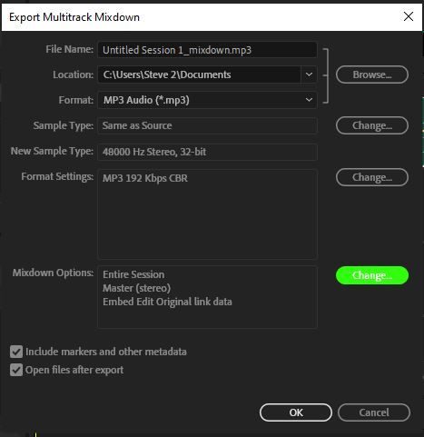

Oct 22, 2019 Oct 22, 2019
Try
If you have all of your sound clips assembled and sounding okay in Multitrack, then you can use Multitrack>Mix down selection to a new file and your mixed file will appear in Waveform view. You can now use Save As (and make the appropriate selection) to save this as an MP3. Alternatively you can use File>Export>Multitrack Mixdown with settings like these:

It's true that .sesx files do not contain any audio data. They only point to the locations on your drive where audio files are stored.
I always like to use this menu combo Multitrack > Mixdown Session to File > Entire Session but anything mentioned here will work.
