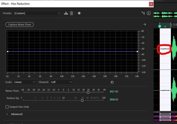

Jan 29, 2024 Jan 29, 2024
Copy link to clipboard
Copied
The Hiss Reduction effect is still broken in January 2024 using latest version 24.0.3.3
With some audio selected...
Clicking the Capture Noise Floor" button in the Hiss Reduction effect only sets the control points in the right channel and not the left channel.  If the audio file is a mono channel file the control points never set.
So what ever is set as channel 0 (left) in an audio file, never gets control points set for the noise floor.
I have conformed this on numerous Windows computers of varying configurations.
If I go back and use Audition 2019, the Hiss Reduction effect sets control points on all channels after clicking the Capture Noise Floor" button.
Votes
Copied
With all due respect, this^ is just not true. If you make a noise selection with the left channel selected, then yes, you will see nothing. But if you now select the right channel, you'll see the noise profile you just created, even though you thought it was from the left. And if you apply it, you'll see it applied to both channels. What's actually 'wrong' is that there's a channel selection at all - it really doesn't need to be there.
What is happening is just the same as happens with process NR. A single FFT profile is created and applied to both channels. If you had a separate one for each channel, whenever there was a difference between one channel and the other there would be a shift in the stereo noise floor, which you wouldn't want. That is why there are only single Noise Floor and  Reduce by sliders, and no splitting.
Yes I agree that the screen layout is, to say the least, a bit confusing. But it is working correctly.
