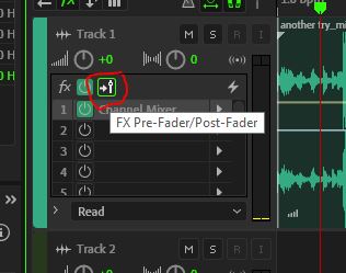

That little button I've ringed gives you the choice. When the arrow points at the fader, it's in normal (pre-fader) mode, but if you click on it, it will turn red and the effects arrow will come after the fader. This applies to everything in that particular rack - you can set this per track though, so they don't all have to be the same.

Thanks SteveG - just to confirm then, the volume level control bar within an audio clip is treated just as a fader?
Thanks again.
-K
Dec 03, 2018 Dec 03, 2018
As far as I'm aware (although if anybody has any better info they can update this), the volume envelope control - the yellow line in the track - is always applied pre-fader. So when it says 'pre or post-fade' at the top of the effects rack, it only refers to the mixer fader. This makes sense really; you'd want to control the ups and downs of a track so that they balanced out before you make the final level decision about it. Well that makes sense to me, anyway...
