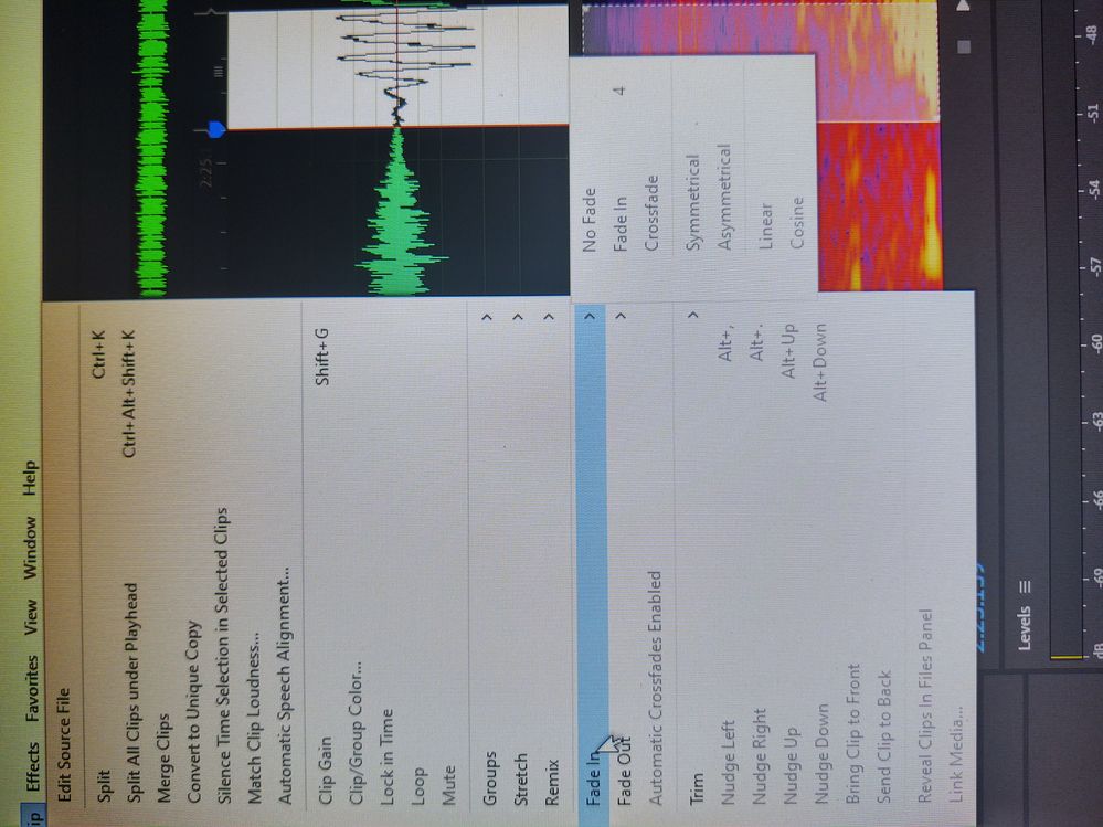

New Here ,
Mar 06, 2021 Mar 06, 2021
Hi Steve I am in the waveform editor and fade in and out is grayed out. Can you help?
That's the list for Multitrack clip editing, which doesn't work in Waveform view. Fade in and fade out are available as options on-screen in the top left and right corners of the waveform in Waveform view. As with everything in Audition, if you're greyed out, you're almost certainly in a view where whatever it is you are looking at doesn't work.

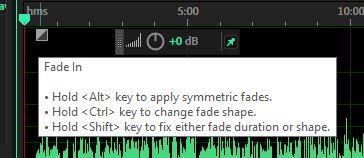

HI Steve
I apologize but I don't see the options in the top left or right of the screen. Can you be more specific? Here is a shot of my screen. Thanks so much!
Hold the mouse over it, the cursor will change and you can drag it about - it's reasonably obvious, but there are options too:
When you drag it around, this happens:
