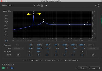

Next we analyse the bumps to the mic stand or whatever that is 🙂
In the rack, apply the parametric equalizer and make the settings below on the first node 1
Hold your mouse on the white dot under the 1 and pull it side to side while playing the
file or a part of it.
You will soon find the frequency that most accentuates the bump noise.
Clue, it's about 123Hz.
Then:
Then reverse the notch at 1 leaving the frequency setting alone and reducing the level to -20dB
Then while playing the file, widen the Q/Width till you hear all of the bump removed.
Lastly fix the reverb using the DeReverb tool!
Settings as above should be sufficient to remove most of the reverb while leaving a litle natural depth.
Once again, you can play with the amounts while playing the audio and listening.
Best regards, Euan.

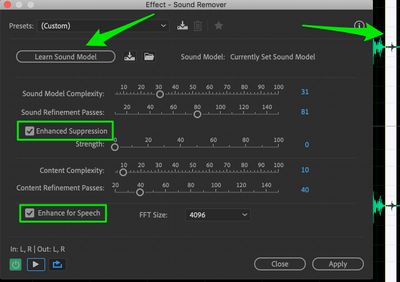

Use the sound removal tool. It'll leave a bit of echo, but it's a one step fix.
Sample the same part of the voice waveform as above with the noise reduction tool.
Click on learn sound model. Apply settings. Experiment
Finish 🙂
To continue the analogy, thinkof this as your food mixer manual 😉
Details on the tool: https://helpx.adobe.com/audition/user-guide.html/audition/using/noise-reduction-restoration-effects....
Best regards, Euan.
