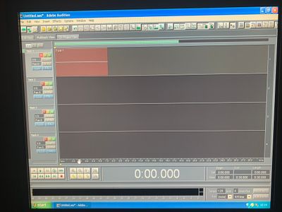

I cannot hear what I'm recording through my headphones.  I'm using Adobe Audition 1.5.  I can hear the instrumental fine.  Can anyone help me?

So...  I found the volume control panel of which you spoke.  I guess I just don't know what to mute and unmute.  I've tried what you've asked but when I mute things so that I can hear through my headphones I'm then unable to get a reading in Adobe.  It's either or but never both (if that makes sense).
New Here ,
Jun 30, 2020 Jun 30, 2020
 Selecting "Line-In" enables me to hear through the microphone.  However, when I got to Adobe 1.5 to record, I don't get a wave to indicate that I'm recording.

I'm sorry.  I feel like I'm doing exactly what you're asking.  On recording, I've only selected the mic.  On playback I have the options to mute wave/mp3, CD player, MIDI synth, CD digital, TAD-In, Auxillary, Microphone and Line-In.  However, no matter what I mute I cannot hear my voice when I record in Adobe 1.5.  I'm wondering if it's an internal problem.  I've literally experimented with every combination of muting within the playback menu.
