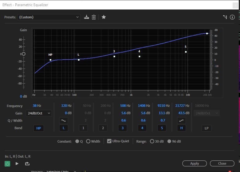

Difficult. Unfortunately you have no content to speak of above 4kHz, and that's where the clarity would have to come from. In an attempt to find out whether there was anything else left above 4kHz, I applied a vicious amount of parametric EQ to it:
and then applied the Vocal Enhancer to it, set to Low Tone (this sounded better than High Tone). It's an improvement inasmuch as the words are a little clearer, but it's not brilliant (pun intended...).

Thank you so much SteveG 🙂 I will try - This is a difficult one I know, and I am new to editing sound, so all help is appreciated. I normally only edit the visuals so I am so happy for your help 🙂
