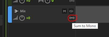

I don't think you've looked very hard...
It's also available in the middle of the master strip in the Mixer view.
Contributor ,
Aug 07, 2023 Aug 07, 2023
That was the first place I looked, Steve, as it's the most logical, but there was nothing there. Same on the mixer. It's there now that it's in stereo.
