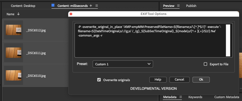

@Lumigraphics wrote a fantastic Bridge script to run ExifTool commands, essentially allowing Bridge to be used as an GUI for selecting files and running commands outside of Terminal.app or CMD.exe:
https://community.adobe.com/t5/bridge-discussions/running-exiftool-from-bridge-with-app-system/td-p/...
P.S. I have updated the previous code examples to remove the underscore before the milliseconds value since these screenshots were taken.

The latest versions of my scripts are available for download on Dropbox.
https://www.dropbox.com/sh/mg817g9a9ymbasi/AADTmXUVxmFfM58bcyYE7yiwa?dl=0

Hi Lumigraphics,
very sorry, but unfortunetely I couldn't get your script RunEXIFTool to work.
What did I do:
- some time ago installed Exiftool (located: "C:\Windows\exiftool.exe"; "C:\Windows\exiftool_files\").
- tested codes provided above by Stephen with ExiftoolGUI direct, and they worked perfectly
- downloaded your script Run EXIFTool from the Dropbox, download directly as *.jsx, no renaming necessary
- copied into Bridge2024/Startup Scripts folder
- started Bridge, Bridge asks for approval of new script, yes
- Preferences/ Startup Scripts show correctly installed script
- Switched to content panel, selected 3 test files, right click, Run EXIF Tool is offered as new option.
So far, so good.
- click - and nothing happens, no new panel comes up, no hidden window either.
What do I miss here?
Sorry to bother again.
Thanks!!
LEGEND ,
Oct 03, 2024 Oct 03, 2024
Hold down command/control key when running it. I need to update the code a bit, it works on Bridge 12 as-is but not Bridge 13+.

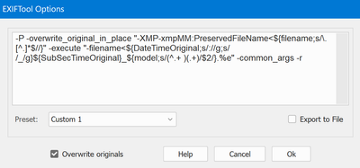

Explorer ,
Ah, ok. Got the panel opening in Bridge 11 with CTRL key (not in 14, as you said).
Entered the same code as you did (except  changing ' into ", I'm on Windows).
And produced a compiling error in vbstemp.vbs ("syntax error at position 166")
Which is position 166? It's the $ ?
vbstemp.vbs:
CreateObject("Wscript.Shell").Run "powershell -NoLogo -NoProfile -Command Start-Process -FilePath 'exiftool' -ArgumentList '-P_in_place "-XMP-xmpMM:PreservedFileName<${filename;s/\.[^.]*$//}" -execute "-filename<${DateTimeOriginal;s/://g;s/ /_/g}${SubSecTimeOriginal}_${model;s/(^.+ )(.+)/$2/}.%e" -common_args -r -overwrite_original \""C:\Users\User\Pictures\Directory\Test\_DSC6510.JPG\""' -RedirectStandardOutput 'C:\Users\User\AppData\Local\Temp\exiftemp.txt' -WindowStyle Minimized", 0, True
Ok, now I'm lost ...
No need to take this up, if you don't want to chew the bone. I'm completely fine with all your help given so far and I've the millisec and renaming problem solved perfectly. Thanks very much once again!

Explorer ,
Oct 04, 2024 Oct 04, 2024
PITA is confirmed. And no, didnt't get it to work in the Command Window.
But I did get it to work in the EXIFToolGUI, which means that it is perfectly scripted.
Is the preferable way to use the command line anyway.
Thanks Lumigraphics!
