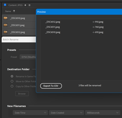

Oct 02, 2024 Oct 02, 2024
@step31519705xkxe
Unlike earlier versions, Bridge 2024 (14.0.0.102) appears to be able to correctly rename using the milliseconds value!
P.S. For the sake of completeness, I'll post an ExifTool command tomorrow and look into a script for renaming for earlier versions of Bridge, it's bedtime now!
Ha, it's buggy!
I quit Bridge 2024 after taking that screenshot, then tried in 2023 where it used 000, then went back to Bridge 2024 and it flaked out and used 000.

And another follow up: I would say it's superbuggy!
Rename procedure, as you did, with the original JPGs, and same result as yours: millisec reflected.
Same procedure with original NEFs: you get 000s and milliseconds are gone.
