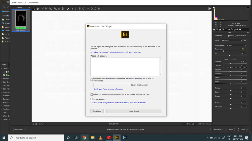

Community Beginner ,
Nov 21, 2019 Nov 21, 2019
Explorer ,
Nov 22, 2019 Nov 22, 2019
the workflow is as described in the original post.
In Adobe Bridge you open an image file directly in Camera RAW (doesn't matter which type of image file, JPG, RAW, etc.), Camera RAW pops up, but doesn't open the file (like the screenshot from luxmash) and then Bridge crashes.
That's it.
