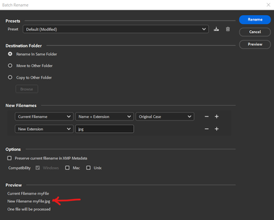

Don't worry, you haven't lost your files. Somehow the file extensions were removed in your batch rename.
You can restore the file extensions by running batch rename again using Current Filename and New Extension.
For Current Filename, try setting it to Name. Check the preview at the bottom to make sure it's correct. If the preview does not show the name use Name + Extension
The challenge is that you have to do a batch for each file type.

@gregreser, thanks for your help! I'm sharing the screenshots of the batch rename settings that caused the issue.
To fix the issues with the photos, I renamed all of them just by adding .jpg at the end of New Filenames under the Text field and it seems to work. Thanks to you, I have all the videos back, but the filenames are completely random. I wonder if there is a way I can recover the original metadata with the proper created date.

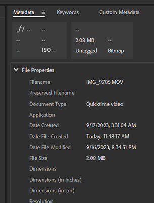

Advocate ,
Sep 23, 2023 Sep 23, 2023
The 1904.01.01 is sometimes added when the real date is invalid or unknown.
What date would you expect for the example screenshot you shared? Is it the Created Date shown in Finder 2023.09.02?
We need to find out if the file metadata has the correct date saved in a different field so we can copy it to the right field for Batch rename.
Let's see what dates are in the XMP:
Select an MOV file
- Open File Info  (Cmd + i)
- Click on "Raw Data" (in the list of panels on the left side)
- Select all of the XMP data then copy and paste that text it into a reply here
Also, what are the dates shown in Bridge File Properties?

Hey @gregreser, sorry for the late reply. I missed the notification.
I was expecting to see the created date, but the screenshot I previously shared had the wrong data.
The attached screenshot exemplifies it better: the file was renamed as 1904.01.01, Bridge File Properties shows it was created on 2023.09.02, and Raw Data shows the correct date, which is 2021.09.07.
I'm unsure how to rename using the Raw Data information - I would appreciate it if you have any suggestions or workaround. I need to rename 5,000+ files. Thanks in advance!
Advocate ,
Sep 28, 2023 Sep 28, 2023
Hi @Jeferson S. it is possible to rename the files using the xmpDM:logComment value, but that field is not necessarily a date field. I would first do some analysis to see if that data is correct and to see if the creation date might be stored elsewhere, such as the device EXIF data. This data is different than the XMP metadata.
I would look at ExifTool. It's a command line tool but is is very versatile, powerful and fast.
ExifTool
MacOS installation
First, you could simply read all the metadata from a few sample files to see what date metadata they contain.
To read metadata from a file:
  1. Launch the Terminal application from your /Applications/Utilities folder.
  2. Type "exiftool" followed by a SPACE in the Terminal window.
  3. Drag and drop files and folders on the Terminal window.
    (This saves you typing the full path names of the files/folders.)
  4. Press RETURN to view the metadata from the files you dropped.
You could also export a list of all the files and their dates to be sure it is consistent.
I would recommend changing the 1904 date in XMP with the real date. This should be easy with ExifTool
Finally, you could rename the files with ExifTool or the Bridge batch rename using the corrected XMP Date Created.
