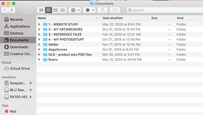

I just updated my Bridge to the latest version and now it won't recognize any of the files on my Desktop or Documents. There are a LOT of files in both places. Can anyone tell me why this is happening and how can I fix this? Also, Bridges shows arrows on top of the Desktop and Documents folders. I've never seen that before. Yet if I click on either of these folders, it won't recognize even one file inside them. I've never had this issues before. Please help?

By the way, I am running Bridge 2020 on Mac OS Catalina 10.15.4

Were you using Bridge prior to updating to Catalina? Have you ever given Bridge permission to access things on your computer and connected drives?
Oh, what happens when you mouse over one of the arrows or click on one of those arrows?

Thanks for responding! Yes, I've been using Bridge for quite a while before and after updating to Catalina and no issues whatsoever. I don't remember ever specifically giving Bridge permission to access anything in particular. It just always worked and recognized everything right off the bat.
If I click or mouse over the arrows on those folders, absolutely nothing happens. It's like the arrows are part of the folder graphic. Real strange.
