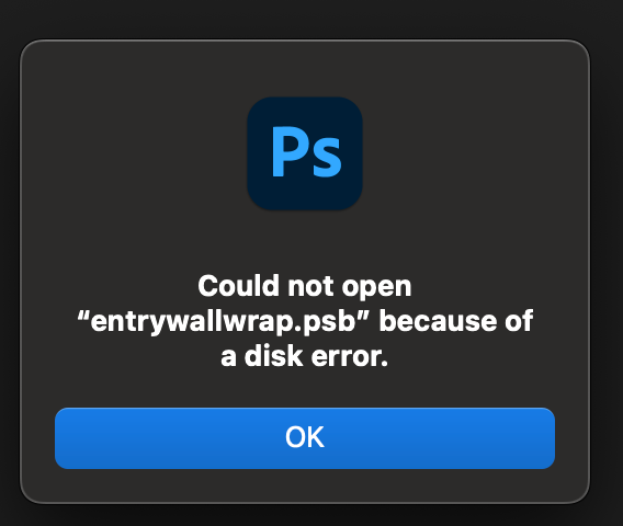

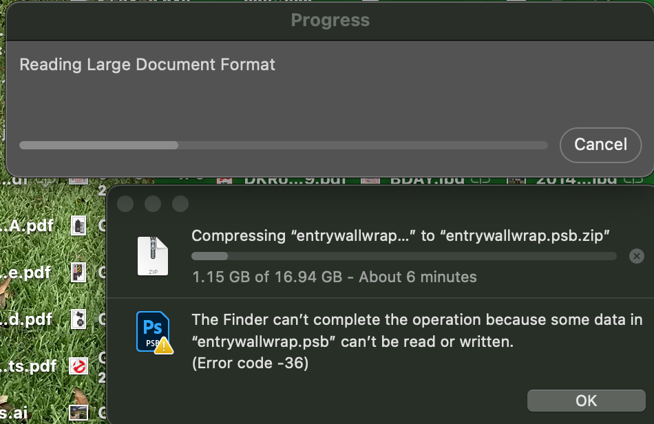

Hi Gary - I'm having a similar problem. I have a 16GB PSB file that saved yesterday around 3:45 p.m. Now, it won't open due to a disk error. I have read some other troubleshooting tips - I have used the one you mentioned and photoshop does have full disk access. I have tried to move the file from an external drive to the main hard drive and it gets caught and won't move past a certain point. I have tried compressing the file, it gets caught in the same place. I have tried uninstalling photoshop and opening with several different versions. Do you have any other suggestions? Thanks!

Hi @gary_sc I'm having a similar problem. I have a 16GB PSB file that saved yesterday around 3:45 p.m. Now, it won't open due to a disk error. I have read some other troubleshooting tips - I have used the one you mentioned and photoshop does have full disk access. I have tried to move the file from an external drive to the main hard drive and it gets caught and won't move past a certain point. I have tried compressing the file, it gets caught in the same place. I have tried uninstalling photoshop and opening with several different versions. Do you have any other suggestions? Thanks!

Screenshot 2023-07-21 at 10.23.00 AM.pngScreenshot 2023-07-21 at 10.21.29 AM.png

I kept at it for a few hours and found a solution. I had tried to move it to the finder but it got hung up. I found a free software called "Disk Drill" and it scanned the external drive and after about 2 hours was able to recover the photoshop file by moving it to the finder. Will take the victory even though I lost several hours of time. Thanks for being willing to assist.

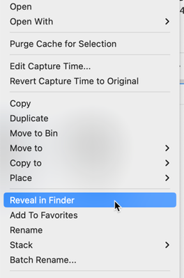

But one thing I do not understand is what do you mean when you say, "…recover the photoshop file by moving it to the finder…" That file was always IN the Finder. Remember that Bridge is nothing but a viewer. It lets you see files in any folder in any location.
In fact, if you right-click on any file, you'll see you can "Reveal in Finder," and the folder containing that file will open up with that file being selected.
