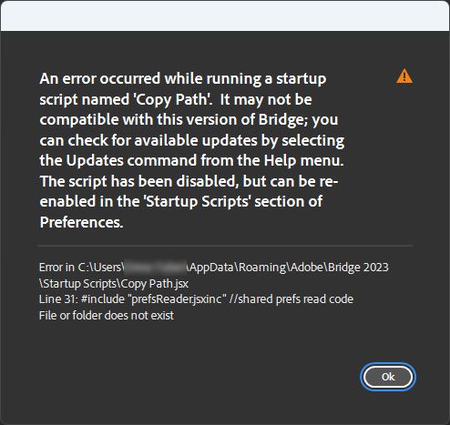

Bridge gave me an error:
So I updated to v 13.0.2.636 (the same version!)
It gives the same error:
'Line 31: #include "prefsReader.jsxinc" //shared prefs read code
File or folder does not exist'
Jan 21, 2023 Jan 21, 2023
Ah, it isn't a stand alone script, it relies on a missing preference file.
You will need to download the entire utility script pack from the link previously provided.
