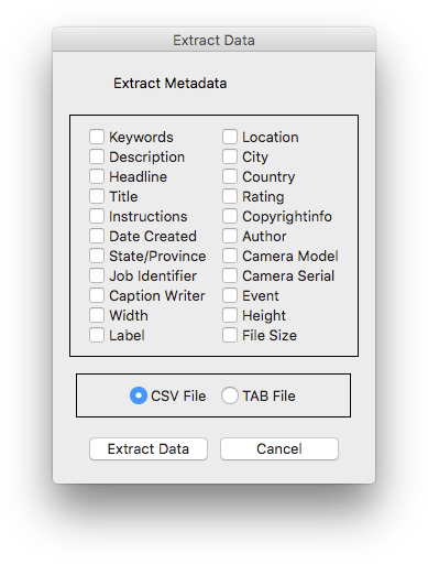

You can start with taking a look at the following scripts:
https://prepression.blogspot.com/2016/08/extracting-metadata-to-csv.html
Although Bridge is probably the best tool for this task, Photoshop can also do the job.
