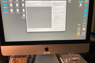

I got the idea because I have a lightning (apple) wire attached to my desktop mainly for charging my iPhone but every time I hook up my phone it brings up Photo Downloader and displays all the photos on my phone. Bit of a nuisance, honestly. But even the problems I have with P.D. not recognizing cards in my card reader, the hard wired phone was showing up and functioning perfectly.
Here is my D810 connected thru my Sabrent card reader. Downloader working just fine.
Here is my CF card inserted into my card reader (I have the same results using other card formats)
The resulting Downloader from CF card directly into card reader
Note that connecting my D810 directly into USB on the back of my iMac also gives a perfectly good Downloader function but is a nuisance to do it that way.
