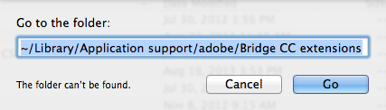

Thanks for your reply, Omke, but we've already been down that route. That's the first place we went actually. This folder: "Mac OS: /Library/Application Support/Adobe/Bridge CC Extensions" does not exist. We have used the Go To Folder pathway and there is no "Bridge CC Extensions" folder at all.

If I read post #1 correctly, you paste /Library/Application Support/Adobe/Bridge CC Extensions into the menu/folder.
Copy link to clipboard
Copied
I did that.
Copied
The Tilde (~) in front is causing the incorrect result.
However, here is a screenshot of the location, mind you, I don't have an English language system but with the translation you should manage to find it, probably in an other alphabetic order on your system. Copy the AOM folder to this location and don't forget to put the workspace in the workspace folder (with the arrow at the bottom)
Hope this helps.

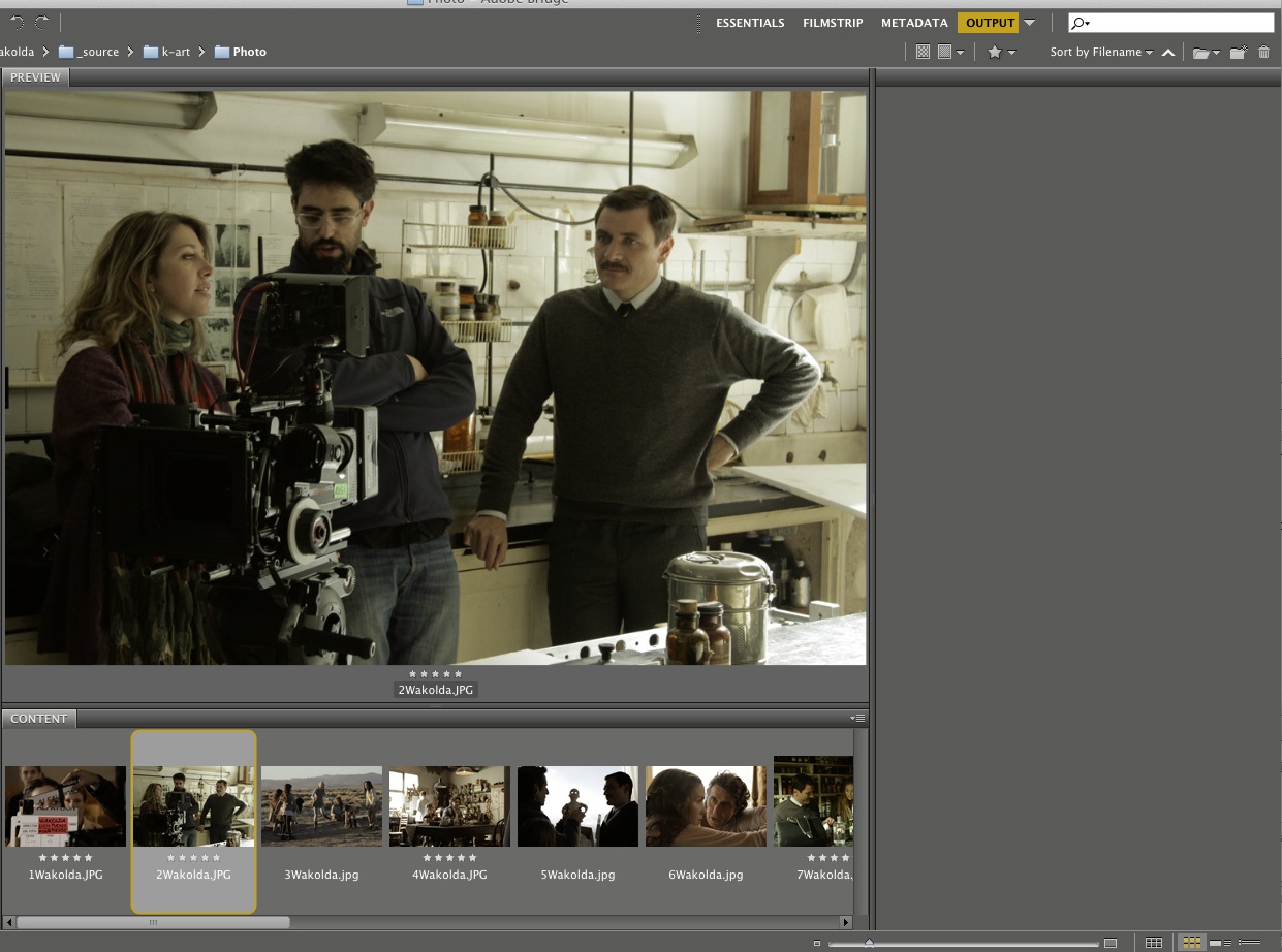

Niestey something is not right. Please see this movie. On the Rights of the root is exactly the same.

At first sight I can' see anything wrong about the correct locations you used.
There was no need to delete all workspaces but that also should do no harm I would think.
You once pointed at the bridge6.plist file but it is not clear to me what you did with it. Personally I would quit Bridge and delete this plist file manually and then restart with again holding down option and use reset preferences.
And you did also use the reset to standard workspaces instead of the reset workspace to only reset the selected workspace. I don't know for sure this will make a difference but it is worth a try.
And while you are in the user library to delete the plist file for Bridge also look in the folder caches in this library.
User / library/caches/adobe/Bridge CC and inhere find and delete both the plug in and cache folder, then restart Bridge.
Finally it might be also worth a try to download CS6, it should not be needed to do so but it was one of the earlier solutions that worked. In your ACC menu click on any app that shows blue and this brings you to the CC website. Choose download center and find PS. Click on the icon and this gives you the detailed download page. Inhere you can change CC to CS6.
Download PS6 it and install it (this also installs the CS6 version of Bridge which was not a separate download in CS6). Then try first start CS6 and start the AOM which is installed by default in this version.
Then when having used this once quit CS6 and try CC (or even combine with restarting your Mac).
Hope this helps, because I'm running out of options

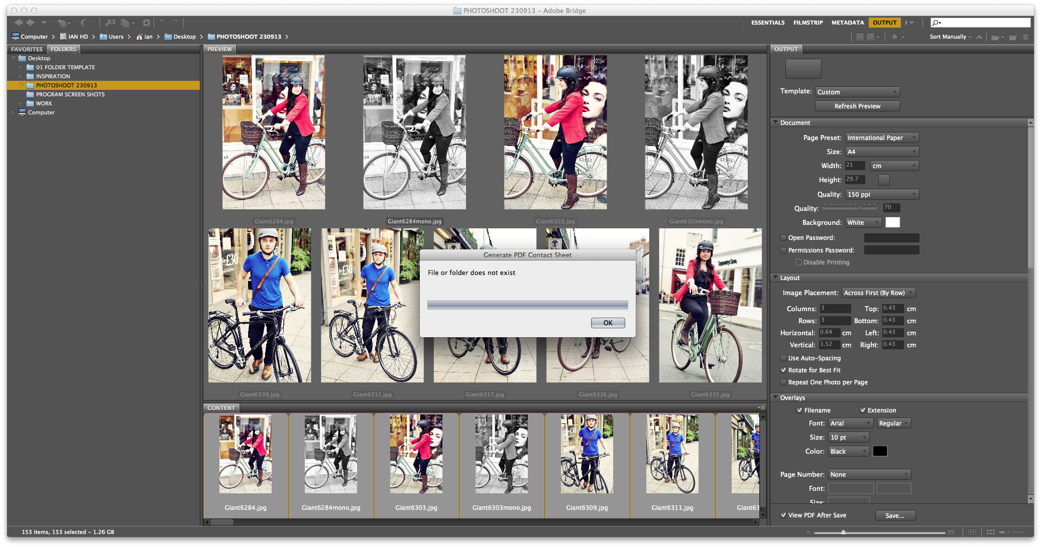

I too have been having all of the above problems since installing Adobe Bridge CC.
I wanted to create a contact sheet of a group of images and while doing so discovered the output had dis appeared from Bridge.
I have followed all the instructions above, replacing 'output module folder' and deleting "!!-$$$AdobeOutputModule.workspace" from my user library; which after a system reboot displayed the output panel in bridge :-).
I then selected my images, changed the output options to what I wanted and hit 'Save'..........and the below error now appears!!!!!
These images are on my desktop, so i'm not sure why it is saying "File or folder does not exist"
Please help, i am growing tired of not being able to complete the simplest of tasks.
Thanks
Copied
Change back to workspace where you can see all the files that have been selected (in your case Essential or create your own workspace) and double check if you have only the images selected.
Otherwise restart Bridge holding down option key to reset preferences and or check and repair permissions for your OSX using Utilities / Apple Disk Utility / check and repair permissions.
