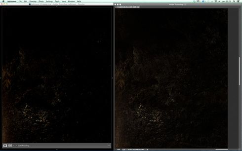

Hi, I've just found a really bad issue occurring in Lr 5 (but also in all other Lightroom versions) under Mac OSX 10.9 with a calibrated monitor: dark shadows (from a value of 20 to 0) are all clipped (pure black with no detail and no textures) while the histogram remains ok, indicating NO clipped shadows at all. This issue afflics also ACR.
Photoshop for now is the only software under MAC that reproduces dark shadows correctly: Library Module shows a bit darker and shifted shadows than Ps but acceptable, Develop Module is really bad showing brutally clipped shadows (but you work in the Develop Module right?!).

p.s.: Added a 100% Crop screenshots that shows the problem, some photos are even worse...

Update 2: I managed to match Ps shadows with the table Eizo profile enabling soft proofing to simulate the Eizo profile in use.
To recap: I can match Ps and ACR shadows with table profiles (both eizo and x-rite) only if I activate soft proofing in the Develop module and set it to simulate the monitor profile in use. At this point it seems that if we want Lightroom to work properly we should skip Colorsync which seems to not support correctly table based profiles. Is this right?

look here, I tried to accelerate the effect, so I did calibration with ultra low contrast
black level 2,0, contrast ratio becomes as low as 51:1
ICC (table?)profile version 2.2 Eizo color Navigator 6.4.7
OSX 10.10.
Votes

monitor contrast
I did an "weird" calibration with low contrast 2.0 cd, 51:1 contrast ratio (monitor get very low contrast)
Eizo Color navigator OSX 10.10, ICC profile 2.2
Is shadow clipping in LR even more visible then? see screenshot
If native contrast 0.2 cd Im sure the effect becomes more subtle. Perhaps most of us have native contrast and does not see the effect so easily. I usually prefer little less contrast on my Eizo, 0.3 - 0.4 cd/m2
