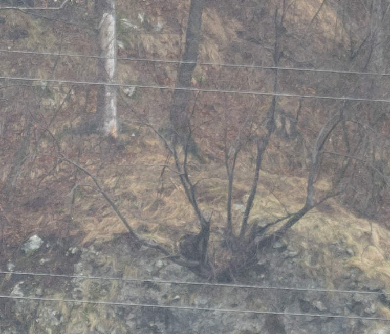

After some times (several months) once I get new version of Camera Raw plugin 13.1 I observed that when I process my images in LrC required a lot sharpening and contrast adjusting. First times I thought that was the quality of original photo, therefor I try more attention when I take the photo (light condition, camera settings). So, after some period of times I observed that doesn't meter if the photo are near to ideal.
The I compared to original software from Olympus (Olympus Workspace) and I found a huge difference between sharpest, contrast and fine details. There are difference in colours, but I understand this as each application has its "colour space" - the technics how the colours are recovered and processed by application.
The samples of crop from applications:
Crop from LrC Develop space. 100 % crop, 1:1
Crop from Olympus Workspace. 100 % crop, 1:1

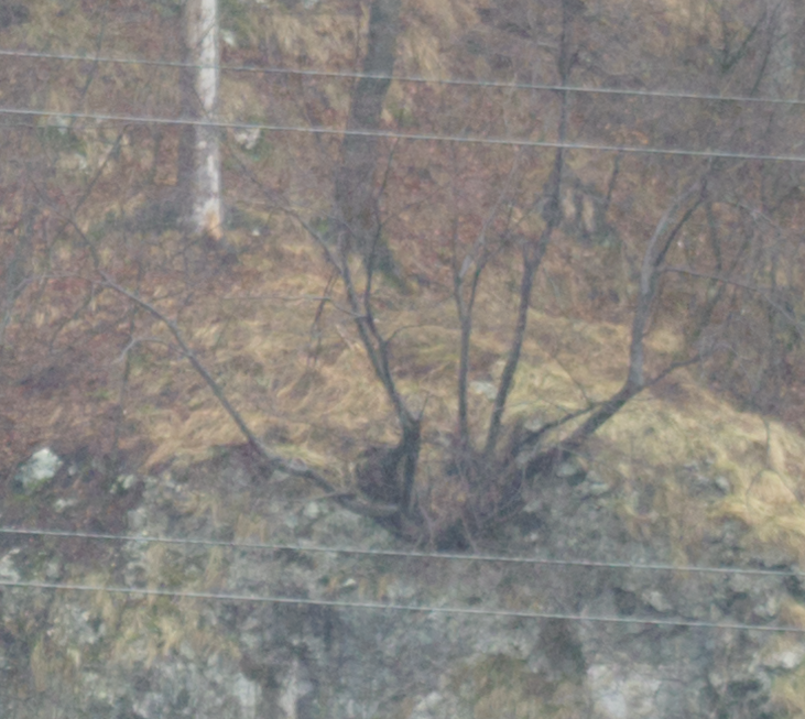

The samples of JPEG files generated by applications:
Crop from Windows 10 Photos application of jpeg file generated by LrC with 100% quality and sRGB colours.
100 % crop, 1:1
Crop from Windows 10 Photos application of jpeg file generated by Olympus Workspace with superfine settings.
100 % crop, 1:1
I downgraded the LrC version to about 1 year ago (some version around december 2019, when I start to use Adobe products). But I doesn't observed any differences, the images remains shash and not sharp.

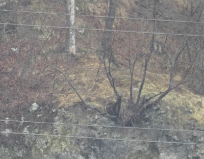

Today I downgraded the Camera Raw plugin to version 12.4 and finally recovered the view of my images: sharp and clean.
Crop from LrC Develop space with downgraded Camera Raw to version 12.4.
100 % crop, 1:1
The view of images from Camera Raw 13.x are not admissible for me. So, will be great if this will be fixed in near future.
Thanks!
p.s.: All samples are without any additional editings or changes settings. Just opened in applications as is, then crop or export.

Explorer , May 12, 2021 May 12, 2021
So, I did an extended test and I concluded that my suspicion was wrong and LrC works correctly or works as before. Camera RAW version also doesn't influence the image quality, either on rendering or preview.
Anyway I started to get a little blurry image more often than before, but I should look for this in other possible sources. Inclusive one of the sources can be myself too.

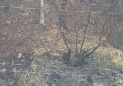

As like resume of my issue: When I start to use LrC in my workflow (december 2019) I use the import of my .ORF files without any additional processing and almost times I didn't required any kind of sharpening or increase of details. Last time (about half year ago, it is hard to detect exact time) I observed that my photos in LrC required a lot of sharping and increase of details, which wasn't usual before. So, I tried to found the source of my issue therefor in my explanation is decribed the path how I come to the conclusion that Camera Raw plugin may the the source of my issue.
To check the render of raw in LrC before (when was ok) as sample is my last image from post.
And the render of raw in LrC after (when is not ok for me) as sample is my first image from post.

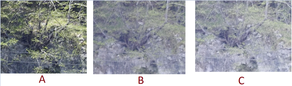

I should explain a bit why I started to suspect LrC or Camera Raw plugin.
What I found is that, for example, the LrC good enough to resolve raw data for .ORF files when the subject and light conditions are contrast enough. In more flat conditions the image looks more washed and harder to distinct the details.
In comparison with original software Olympus Workspace, where the same image looks cleaner from more points of view: sharp, colours, ... . Like @ssprengel  also wrote and present a example, by adjusting the sharpening can be achieved close enough results with image from Olympus Workspace, but this adds additional noise. By resolving the noise, image looks more plastic. I'm still learning the LrC, but at the moment I didn't achieve close enough results as Olympus Workspace for "trouble" images.
A sample of images:
Snapshots from LrC, all snapshots zoomed to 100%, all images was taken with camera mounted on tripod, shutter with 2 seconds delay, image stabilization on, focal length 150mm on MFT (300mm on 35mm sensor equivalent), distance to the subject is estimated to about 1km.
Image A - is when the light condition was contrast enough, direct sunlight at angle about 60 degree. Details about sharpening is "Amount: 0". Exposition info: ISO 200, 1/1000, F2.8. Focus - manual.
Image B - is when the light condition was flat, a dense cloud covered the sun. Details about sharpening is "Amount: 0". Exposition info: ISO 200, 1/1000, F2.8. Focus - manual (was the same as image A, because image was taken sequentially ).
Image C - is the same as B, but with added sharpening: Amount - 40; Radius: 1.0; Detail - 25; Masking - 35

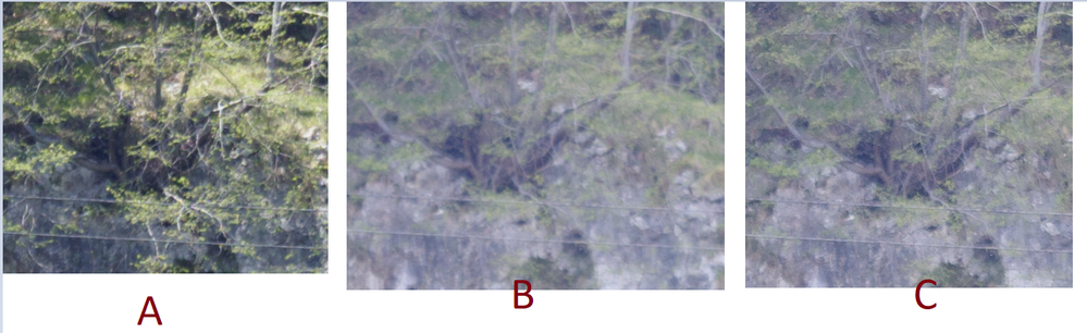

For comparison the similar snapshots from Olympus Workspace
A, B, C images are the same A, B, C described in LrC snapshots (the same .ORF files). The zoom is 1:1.
Image A - is the same Image A described in LrC snapshots
Image B - is the same Image B described in LrC snapshots
Image C - is the same Image C described in LrC snapshots, with sharpening adjustments: Color grading - AUTO, Sharpness - +0.8
Looks that confused me the images were taken in flat light conditions, where in LrC looks not good enough by default. But adjusting the details of the images can be changed to be at some acceptable conditions. Where the original raw processing software by default (without any adjustments) looks more acceptable from the beginning.
