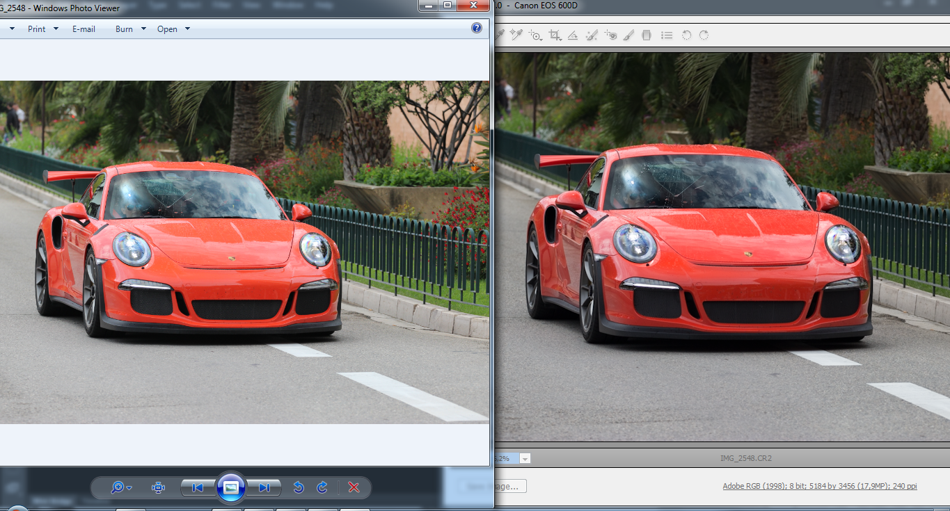

pspr.jpgSince a few days I have this problem with raw files. Anyone have any idea? Red go to purple and all pictures are a little bit darker.

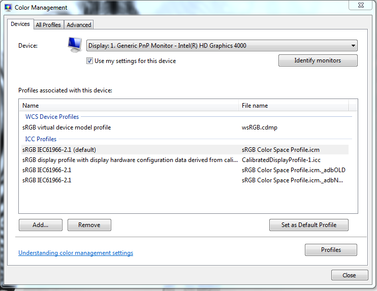

That's a defective monitor profile. Recalibrate.
Windows Photo Viewer is fully color managed, and these two should display absolutely identically. All color managed applications should always display identically (that's the whole point).
Broken monitor profiles can often affect different applications differently.
If you're not using a calibrator, you probably got a bad manufacturer profile through Windows Update. In that case replace it with sRGB IEC61966-2.1 for now (use Adobe RGB if your monitor is a wide gamut model). Relaunch all apps so that they can load the new profile at startup.

Thanks for help, but I've made the calibration and also I set up sRGB IEC61966-2.1  in Color Management. The problem still persist.ad1.JPGad2.JPG

I have only one display, you can see my settings.

If this only happens with raws, and you’re comparing with what you see in Windows Photo Viewer, then isn’t the issue merely that you’re viewing the camera JPG processing in WPV (as shown in the camera-embedded jpg preview of the raw) with the Adobe default processing? The camera-processing and Adobe-processing wouldn’t be identical, usually, so what you’re seeing may be normal.

Indeed. Are we really looking at shooting raw + jpeg here? In that case everything's normal.
OTOH if Windows Photo Viewer is showing the processed raw file, then display profile and/or GPU is the only possible explanation. Not only the most likely, but the only possible.
LEGEND ,
Apr 01, 2017 Apr 01, 2017
One of each of the side-by-side comparison shots is from Windows Photo Viewer, so while WPV is color managed on newer OSes, it would be showing the camera-embedded JPG preview or a Microsoft-raw-engine rendering, at best, compared to whatever we’re seeing in Adobe software.
So is the problem that the raw-in-Adobe and the raw-in-MS or JPG-in-MS aren’t the same? If so then that is to be expected, although you might be able to get the Adobe rendering to match the camera at little more if you set the Camera Profile to Camera Standard (or whatever Camera-centric color profile you like) instead of Adobe Standard, all in the Camera Calibration tab of the Adobe Camera Raw plug-in.

" So is the problem that the raw-in-Adobe and the raw-in-MS or JPG-in-MS aren’t the same? "  The raw is different from JPEG, also the raw in Photoshop, is different from JPEG. But JPEG directly in Photoshop have no problem. Only raw files has different colours. Unsolvable yet.

First of all - when you set profile in Windows Color Management - don't use the "virtual device" WCS profile. That's not a standard icc-spec profile and won't work as intended. It has other purposes. You must use sRGB IEC61966-2.1 specifically.

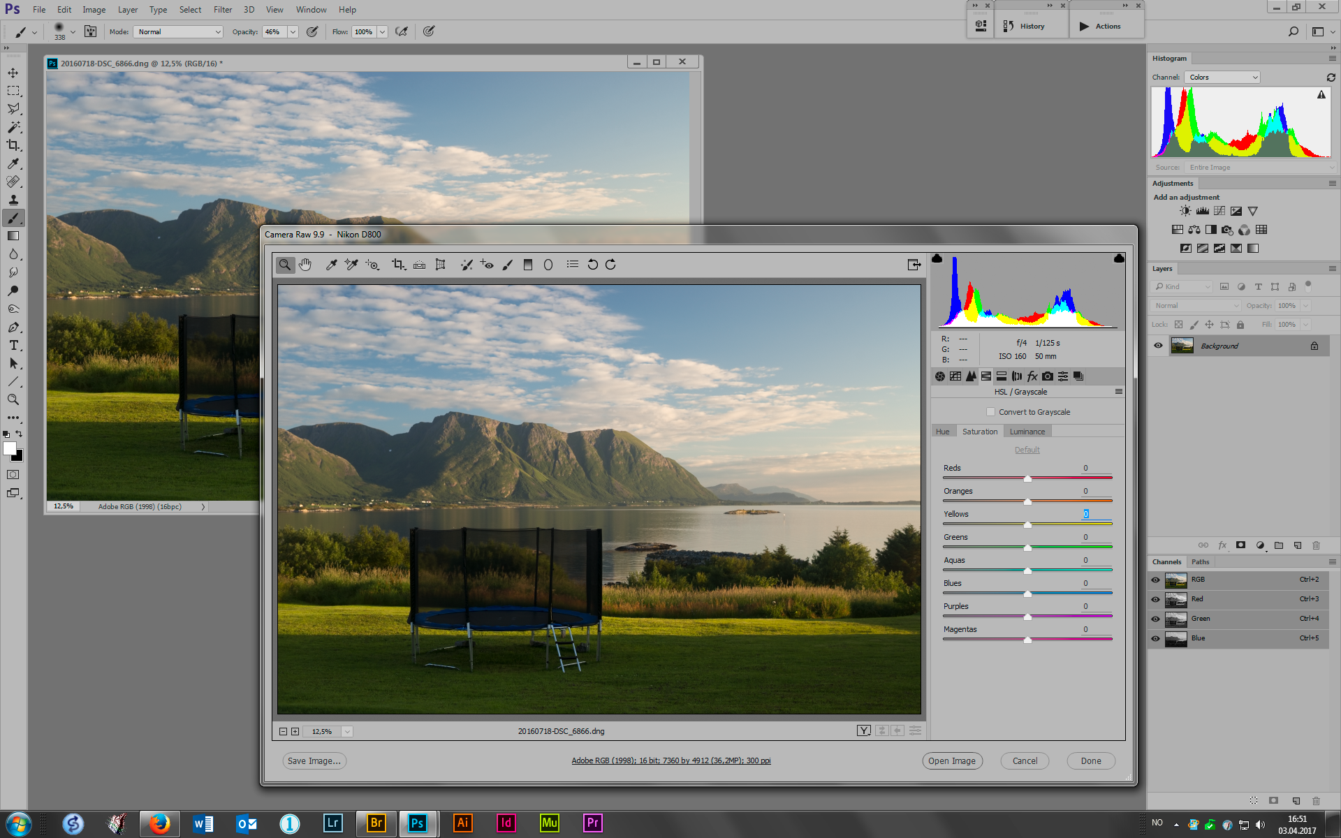

The first and most important test is this: Do you see any differences between ACR and the same raw file opened from ACR into Photoshop?
I'm assuming here that you set your color management policies back to "preserve embedded profiles".
If there is a difference here, there are only two possible explanations. Bad display profile, or GPU color management not working as it should.
Next you can compare Photoshop to Windows Photo Viewer the same way.

In your picture, on my display the file from ACR is more brighter than the ACR in Photoshop.
You can see the differences : the firs picture is raw file opened from ACR into Photoshop, the second picture is raw file open in ACR and the last one is jpeg file opened in Windows photo viewer.
Apr 04, 2017 Apr 04, 2017
No, it is not, you are just one of many being tricked by the dark interface in Photoshop. Those two are identical, so we can safely assume that everything here is working as it should, and that this is the correct version.
As for Windows Photo Viewer - this really, really looks like it's showing the embedded jpeg, not the processed raw file. Just as ssprengel suggested. So the question is - how did this jpeg arrive in Windows Photo Viewer? Where does it come from?
The embedded jpeg will not match the ACR processed raw file. It's not supposed to, this is Canon's choice of rendering vs. Adobe's rendering.
The only other possible explanation is that you have somehow managed to disable color management in WPV: In that case this is again an expected difference.

Jpeg come from my camera, I photographed in raw+jpeg.
Ah, OK, finally we got to the bottom of it.
Everything here is perfectly normal and working as it should.
As has been pointed out several times, the camera jpeg will not match ACR, it's not supposed to. The camera jpeg is processed in camera, by Canon's camera firmware, and represents Canon's idea of how the image should look.
In ACR you're supposed to create your own rendering. The ACR defaults are just a starting point. The rest is up to you.
There is no such thing as a "correct" or "accurate" rendering of a raw file. You can look up a large number of previous threads here concerning this.
