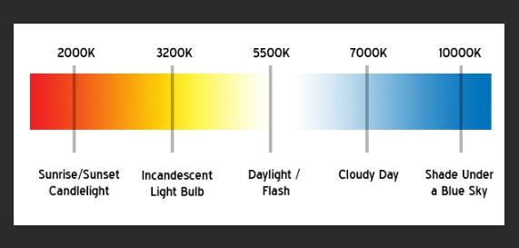

ACR shows white balance measurment with lower tempatures representing colder or bluish tones and the higher tempatures representing warmer tempatures/tones. However other measurement scales of WB tempatures show the opposite with lower tempatures representing warmer tones and higher tempatures representing colder or bluish tomes. Which is correct and why is ACR opposite to the other measurements?

I don't profess to be an expert. However, I have been using Lightroom and Photoshop for many years and I don't recall ever seeing the scale represented with the temperatures as you describe. Daylight temperature has always been at 5500, and the lower the number from that point the bluer the color, the higher the number from that point the warmer would be the color when making adjustments. At least that has always been the way it has worked for me.
bainbruAuthor
December 24, 2019
sent twice by mistake Thanks for the help. What I am referring to is that Adobe's measurement of white balance differs from the measurement used by others. Adobe indicates lower temps are bluish and colder and higher temps are warmer. I you google white balance measurement the results are the opposite. Lower temps are warmer and higher temps are colder. See attached.
