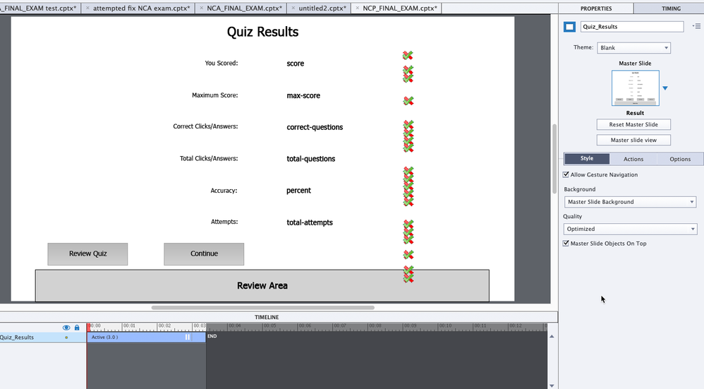

Actually it looks like maybe I do allow review, but there is no review button on my results slide at all. Would this be causing the problem?

Indeed you do allow Review but someone has messed up the score slide.
On quiz/score slides you have embedded objects. Those objects have no individual timeline, not on the master slide and not on the actual slide.  That results in a timeline where you only see the slide tmeline. But in your screenshot I see several shapes, and one of them is even activated as a button. This is not the default score slide, and I fear that some essential items have been replaced by custom items, which also can cause the loss of the functionality. You still have the Review area and the Continue button which is linked to the pausing point of the slide. Try to re-apply the original Result master slide. Look at it: it has all the inbuilt buttons, not only the Continue button but also the Review and the Retake button. It is a non-responsive project, so it is possible to drag the Review under the Retake button.

It is possible that the results master slide has been messed up, can you show a screenshot of that master slide? I suppose that you used the button 'Reset Master Slide'?

Yes I used the reset masterslide button.  Actually.  my whole process was
  1. Copying in a slide with a different theme
  2. In the properties panel of the quiz result slide selecting  the "Blank theme"
  3. Reset master slide.
It then looks like this
So I deleted the extra continue button
and it looks like this
This is what the blank master looks like in master view
LEGEND ,
Mar 22, 2024 Mar 22, 2024
You are now getting more themes in one project, I know that this is possible, but can cause a lot of issues. I never understood why the team introduced multiple themes in projects with version 11.5.5 when they are aware of the fact that lot of Captivate users don't even know anything about themes. I have seen projects where all blank slides are linked to another theme.... Especially with the master slides belonging to quizzes you need to be extremely careful.
Master slide from that Blank theme is OK. Both the Retake button and Post Result button are optional. The first is only needed when you have activated multiple attempts on Quiz level, the second is bit outdated and only used with the workflow of an Internal Server (no LMS). The Timeline is clean: all the objects on the slide are embedded, whereas in the other score slide you had 3 custom items added. That is fine for non-interactive objects like the variable above the title, but replacing the original Continue button (which is responsible for most of the functionality) is very bad.
