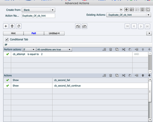

5. I created an advanced action (cb_hint) so that when the user clicks on the greater (false) click box they would get a first error message and a button to continue (see first decision below):

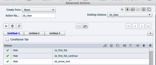

6. I created another advanced action so that when the user got that first error message and clicked on the button to continue to the second try, the screen would clear again:
*Up to this point, everything works perfectly. After this step, though, things don't work.
7. In the advanced action shown above in #5, there is a second decision. When learners click to clear the screen as desribed in #6, they get a second chance to click the box correctly. If they click correctly they get the get the box and continue button to advance as described in #4; if wrong, they are *supposed* to get a section failure message, which I tried to rig as a second decision on the advanced action cb_hint, but since this is where things stop working, I'm assuming it has something to do with the increments or condition in the Fail decision (I have tried to set the condition as "if cb_attemp is equal to __" 1 and 2 but nither worked):
When the user click to clear the screen (point #6), the screen clears. But when the click in the wrong place a second time, nothing happens, i.e. the Fail decision above doesn't work.

BTW: to show a multi-decision advanced/shared action, please use the Preview window for the screenshot, because it will show all decisions in one view. Use the button in this screenshot ot see that window:
That way we are able to see the complete advanced action instead of only one small part.
