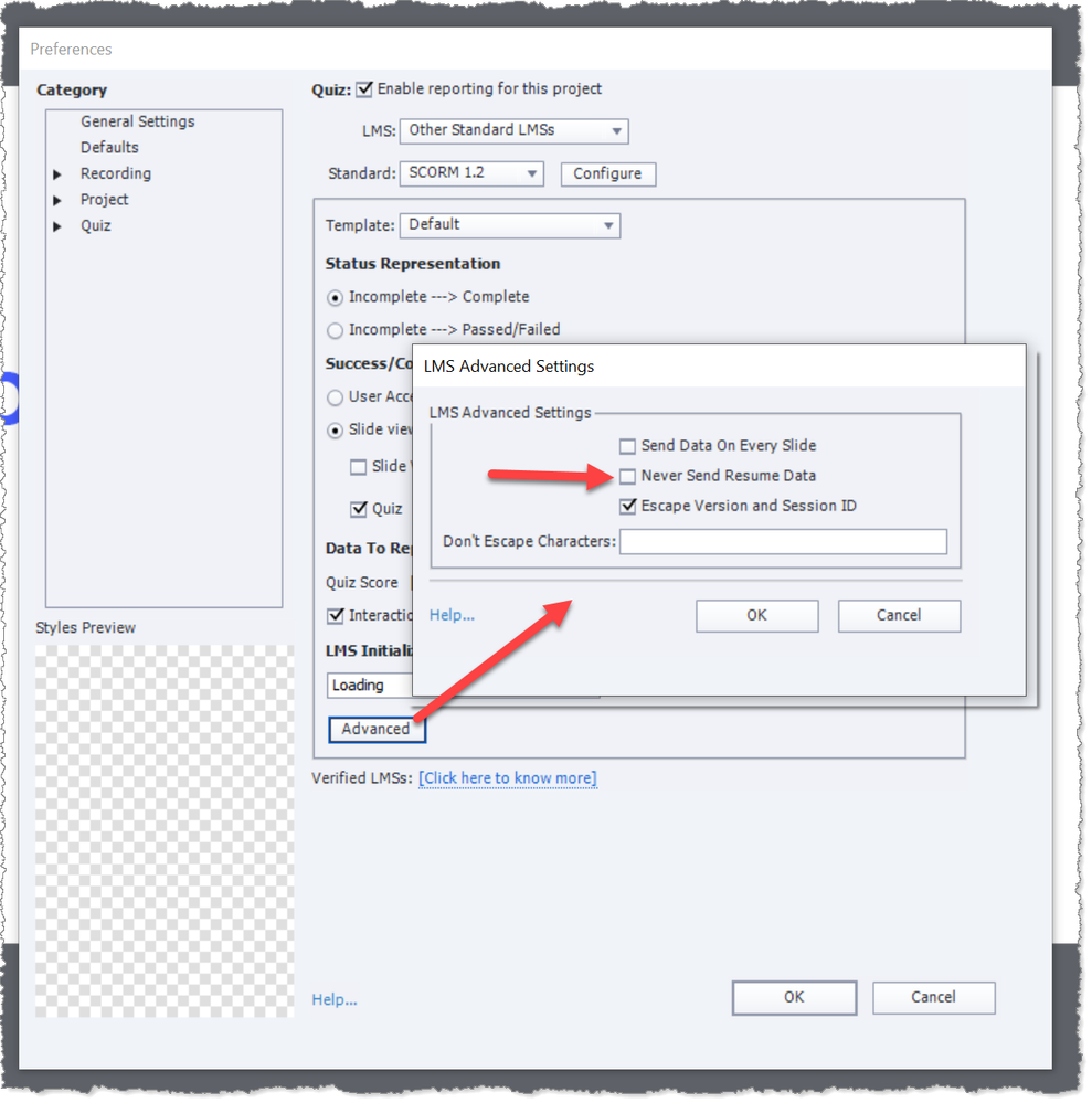

I would first  make sure that your bookmarking settings are correct.
If you are using an LMS then Resume Data Bookmarking should be turned on in Quiz Settings > Reporting > Advanced with the Never Send Resume Data checkbox UNCHECKED.
The second thing you need to check is that you do NOT have Self-Paced Learning Bookmarking turned on at the same time.  This is configured under Project > Table of Contents > Settings.
Self-Paced Learning Bookmarking is turned ON by default in all new Captivate projects. It works by saving cookies in the user's web browser local storage area to record which slide they reached at the end of their last session.  But this should not be used in conjunction with Never Send Resume Data bookmarking because the two methods can sometimes conflict.
Once you have determined that your project is ONLY using Resume Data Bookmarking, then I recommend you test your SCORM package in SCORM Cloud (you can get a free test account) to see if a different LMS shows the same behaviour.  Many times these types of issues are simply due to the differences in the ways that each LMS decides to interpret the SCORM standard.  Usually, if Resume Data is turned ON, and the LMS is remembering what the learner did in their last session, the LMS thinks the user has not yet completed their attempt on this module.
