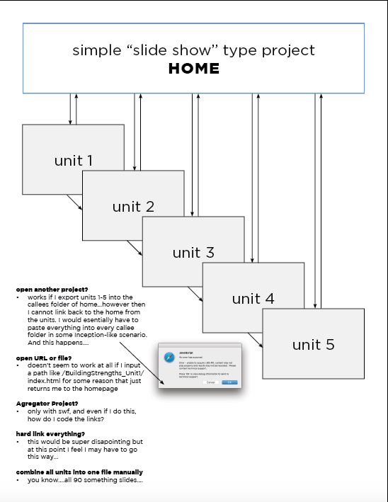

I have this same issue and like sveinevn‌ I need to the to link in BOTH direction (ie: from home to unit 1, and from unit 1 to home) so putting the units into the callees folder only works in one direction. I am going to insert an image here of the simple navigation map I am hoping to archive. AT the bottom I have noted all the methods I have tried to use, but here are my notes in case the type on the image is too small:
open another project?
works if I export units 1-5 into the callees folder of home...however then I cannot link back to the home from the units. I would esentially have to paste everything into every callee folder in some Inception-like scenario. And this happens....
open URL or file?
doesn’t seem to work at all if I input a path like /BuildingStrengths_Unit1/index.html for some reason that just returns me to the homepage
Aggregator Project?
only with swf, and even if I do this, how do I code the links? I am aiming for HTML 5 here.
hard link everything?
this would be super disapointing but at this point I feel I may have to go this way...
combine all units into one file manually
you know....all 90 something slides....

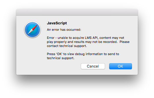

I think right now I just need someone to tell me that this is NOT doable in captivate so I can give up trying to find a solution and just let client know it can't be done.
Thanks!

OK.  Then to have seen that error message you must have inadvertently turned on LMS Reporting in your Quiz Settings.  That's the only reason it would be complaining about not finding an LMS API when you run the content.  Look in your Quiz Settings and deselect the Quiz Reporting option to get rid of that message.

That is exactly what happened in the one unit (accidentally checked the reporting). Unchecked now
