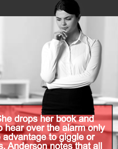

I am noticing that after I publish my course and share through SCORM Cloud that some objects are misaligned on some of the slides. But when I go back to the course and preview in the Captivate App, all is fine.
I don't want to share a messy finished product so I'm curious if anyone has come across this issue and have advice on how to remedy it.

I believe that it is a responsive project. It's been a while since I began it, but "Save as Responsive" is not available to me, which I believe means it is already responsive. Is there a way to check?
None of the objects in my project have been unlocked from the fluid box and I confirmed that "maintain aspect ratio" is not enabled.
I used the preview in SCORM Cloud option and everything looked fine, but when I zip and publish to SCORM Cloud as an invitation for reviewers, several objects are still misaligned. See screenshots in thread below.

Captivate 2019. 11.5.1.499. OS is Windows 10. I believe I selected responsive project, but not sure how to verify (it's been a while since I began the project). The preview versions that show everything fine are "Preview to Devices" and "Preview to SCORM Cloud." However, as I note above, when I zip and publish to SCORM Cloud as a URL invitation, several objects are out of alignment. See screenshots for a couple examples. You may view the course at https://cloud.scorm.com/sc/InvitationConfirmEmail?publicInvitationId=1a6c525d-4418-4f1a-812e-ed89439...

As far as the fluid boxes, I went through all the slide timelines and verified that all objects did not have "unlock fluid boxes" checked. I'm not sure about the "dimmed" items you are referring to in the timeline. I posted a screenshot of one of the slides where the objects are misaligned for reference. In app, all appears fine. Contrast the waist of the character top right w/ the previous screenshot. Scenario 1_in app viewable.PNG

I am sorry but you seem very new to Captivate's Fluid Boxes. If you had at least posted a full timeline..., not with parts cut off (first column misses).  I am almost sure that your issues are due to bad setup of fluid boxes.
