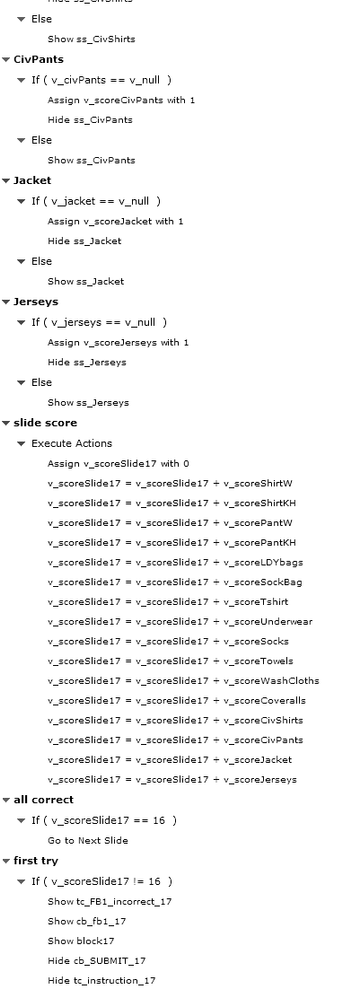

I've seen a lot of posts on how to compare a value to v_null in order to make sure a field is not left blank. I'm trying to solve the opposite -- I need some fields to actually be blank and can't figure it out.
Help! (please!)

I'm trying to accomplish the same thing and what occurs to me after reading this is to attach an action so that if the user even clicks on an unacceptable blank it assigns that blank's variable as Done. Then, you can add to the advanced action that if "unwanted blank" = Done it marks it wrong. If ≠ Done marks it right. I'll see if that works for me.

The variable v_null appeared in one of my blog posts 9 years ago, see that it has been taken over by many. That post has been updated recently:
http://blog.lilybiri.com/where-is-null-in-cp2017
Can you explain exactly what you want to do? Normally the logical expression with 'equal to v_null' should work.

Thank you so much for replying.
Our project is teaching users how to fill out specific forms. In many cases it is imperitive that the user understand that the standard is to leave a field blank vs entering a zero.
Equal to null works... but so does entering zero.
I've tried 'contains' as well, no joy.

As I tried to explain in the blogs, the workaround is due to the fact that blank, zero, all strings are considered to be not numeric and equal to 0.  A variable has no type, it can be a string or numeric.  Can you post a screenshot of the advanced action (use the Preview screen) you are using ? Tell which event is triggering the action and how you tested.
