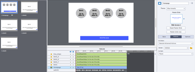

    Lilybiri
    LilybiriCorrect answer
    Jan 8, 2023 10:41 AM UTC
    Mam, I have tested the project & works fine.
    Here is the link to a blog post with a step-by-step workflow:
    https://blog.lilybiri.com/menu-slide-forced-view-and-different-audio-on-revisit
    I will probably post it in the eLearning community as well, but moderation waiting time there can be very long.

    Lilybiri
    Jan 2, 2023 5:51 PM UTC
    You can have only one audio as slide audio. If you don't need CC for the second audio, this may be a possible scenario:
    • You need a tracking variable for each slide. It can start with a value of 0. Either with the On Enter event, or with the event linked to a Next button you can increment that variable, or just toggle it to 1 (Boolean variable).
    • You have to test the value of that variable with the On Enter event, if it is equal to 1 or greater than 1, you have to move the playhead to the end of the first audio clip. Use the Play Audio command to play the second audio.
    To write out the full advanced action I need to see the Timeline of that slide, and an answer to my first question about CC. Do you have a Next button on that slide or not?
    Phoenix_Leo
    Jan 2, 2023 6:00 PM UTC
    No mam, this slide doesnot have next button and only the slide audio will have cc and the second audio will not have cc.
    Timeline Screenshot:
    Mam cud you suggest how to write the advanced action?
