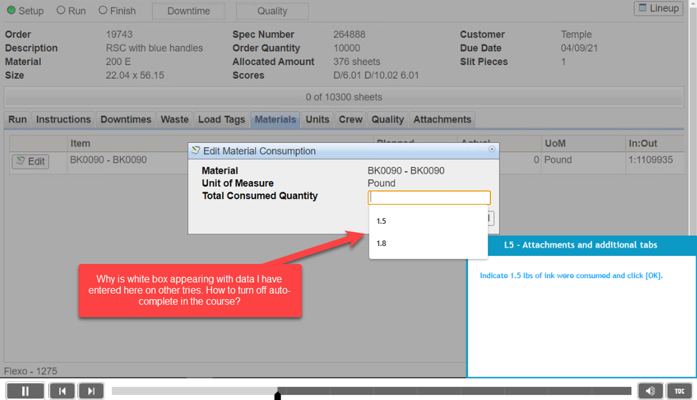

Hi, having same issue. Were you able to figure out how to turn off auto-fill (I don't understand how anyone is using TEBs with this issue? Surely someone has figured out how to turn this off?). I have been told to set autocomplete="off" on the TEB, but no idea how to do (I am a Cap 19 beginner!)
New Here ,
Apr 15, 2021 Apr 15, 2021
Note: I named my TEB variable TE_L506. Wouldn't think this is a field that would be auto-filled. But Adobe Cap19 TEB autocomplete issue.png

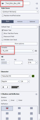

Advisor ,
What is the name of your actual TEB field?
If the other code options above are not working, perhaps try the following adjustment where you replace only the word  entryBox with the name of your TEB.
Keep the  quotes, hash, and _inputField in place.

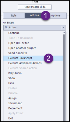

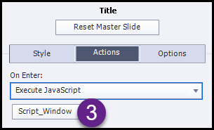

How/where do I place an... Execute JavaScript  onEnter action?
(apologies as I am a beginner!)
Advisor ,
Here are some pics to help.

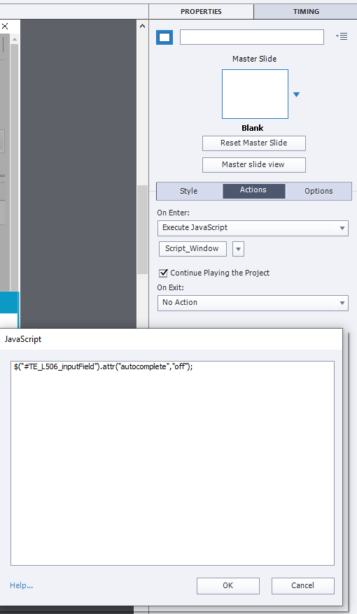

New Here ,
I set JavaScript on slide [On Enter] - Do I have this right?
Now, when I get to this page of training in Chrome,  Chome opens a new blank tab?
Advisor ,
Looks like you have the right place.
However, you will need to use the name of your text entry box rather than your variable name.
From what I can see, the name of your field is
Text_Entry_Box_L506
I would not expect it to open a new tab in your browser, though.
$("#Text_Entry_Box_L506_inputField").attr("autocomplete","off");

New Here ,
Thankyou changed Javascript to...
But when I come to this slide, still showing auto-complete box and still opening blank tab.
