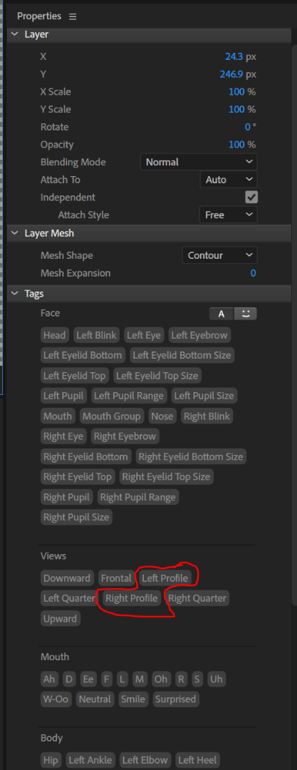

LEGEND ,
Oct 12, 2018 Oct 12, 2018
I think you are missing the tags on the top level profiles... oh! See you called them "Right Profil" (no "e" on the end). So that layer will not have been autotagged. Instead if found your head profiles and thought they were your body profiles! Then it looked for all the handles under the profile (which is Left Profil/Head/Left Profile in your case - a part of the head). Your handles are not under head (of course) so CH did not find them.
If you tag your "Right Profil" layer near the top with the "Right Profile" tag (in the Tags section of the puppet properties panel) and do the same for the left profile it will hopefully start working. (Or rename your layers so the autotagging kicks in - but that may loose any rigging under those layers.)
Community Beginner ,
Oct 13, 2018 Oct 13, 2018
it did finally work!!!
