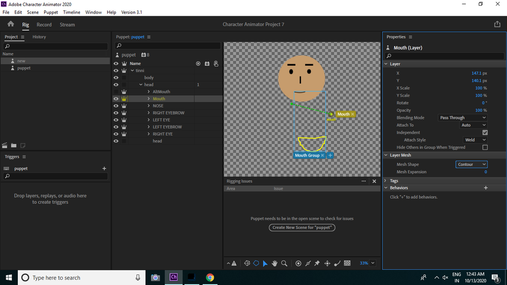

New Here ,
Oct 12, 2020 Oct 12, 2020
LEGEND ,
See how the yellow outline looks like the mouth, but its in the wrong spot? Go into Photoshop/Illustrator, expand the "Mouth" layer to show all the children layers, then put the eyeball on for all of them. I think you will discover you moved the Neutral layer and resized it, but all the other alternative mouths did not move/resize. Resize them so they all overlap in the right space, then save that file. If it works, hide all the layers except Neutral again.
