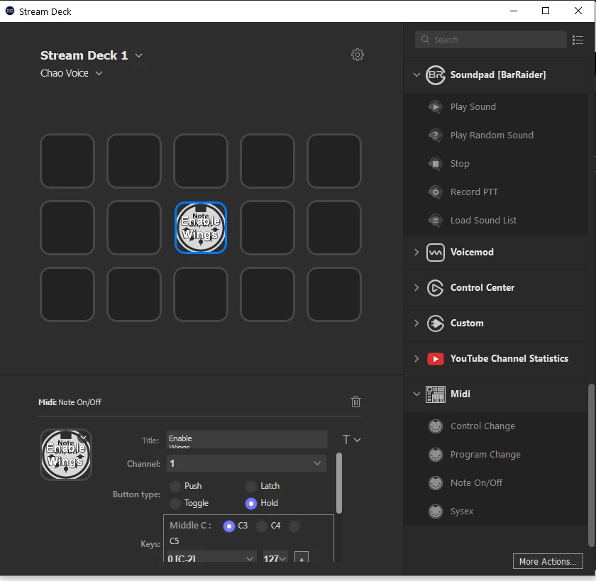

I would like to use a Elgato Stream Deck as a MIDI device to control Character Animator when the program is out of focus. Stream Deck has a plug-in called "MIDI" that emulates a midi keyboard. However when I press the Stream Deck's key the Character Animator does not detect it. Has anyone else got this to work?

sorry totally forgot...ts been awhile since i have used it..there is a program called Loopmidi..look that up on youtube..how to link to streamdeck etc.
April 5, 2021
you still need the midipad unfortunately...use midipad in CH and set the trigger to say "key 64" then you install midi software on the streamdeck which you have install already and link the button to "key 64..the set the toggle or latch option.
jawdoeCorrect answer
April 5, 2021
TheWax70
TheWax70Author
April 5, 2021
Loopmidi did the trick! Thanks!
