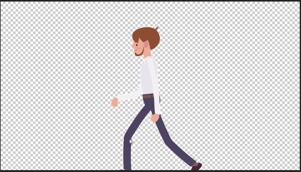

  • at the start of the Animation the Character dips below the ground. This also happened in some situations where I used the keyboard to trigger the animation. In my case I could walk around the problem by rendering a 2sec Walk Cycle and ignoring the 1sec but in other situations this could be a major problem I guess

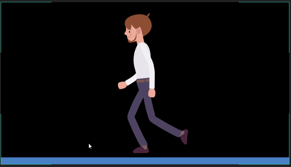

  • my Character also moves slightly up and down where his feet should stay on the ground. At the start of the WalkCycle his heal touches the ground but during the phase where the leg should stay put it slightly lifts up and goes back down.

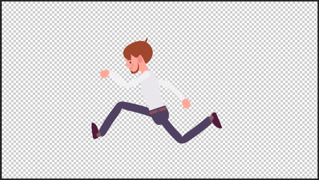

  • his running style also looks really funny and probably can't be used in most situations (it is probably hard to tell from one image but trust me :-)) I guess to some degree it has to with the Character in general and his long legs, that are pretty tricky to animate, but maybe there can be done something against it in a future version of CA

I ran a quick experiment with a single layer puppet created from the screenshot and while the walk is wonky due to it being a single layer (warpiness around the hips due to the lack of warp independence and no arm movement because I didn't cut those parts out as separate layers), but the feet were contacting the ground at an appropriate level and didn't have any weird dips at the start.
In the Rig workspace Puppet panel, it'd help to see how you have your handles placed. Also, in the Walk Behavior section of the Properties panel there's a Handles section that can be expanded to see if the Walk behavior is finding all the handles. It will generally try to get by even if not all handles are tagged, but weird behavior can result.

Yep, got it. The rigging does seem fine (all handles well positioned and accounted for), so I'm not sure yet what is causing that bounce. We've noticed the footfalls sometimes have a "stompy" quality to them, so I wonder if this is a more severe version of that (possibly related to the leg length as you suggested, especially given the relatively shorter length of the feet).
I can also confirm that the first frame of my render has the issue you mentioned about being mispositioned below the normal floor level. I have an open bug on a problem where the first frame had a leg in an odd position, so it is possible this is some variant on that issue, but I'm not sure yet. The walk behavior does have some logic to pick a baseline based on analyzing the handles, maybe the render of the first frame is somehow happening prior to that initial setup.
