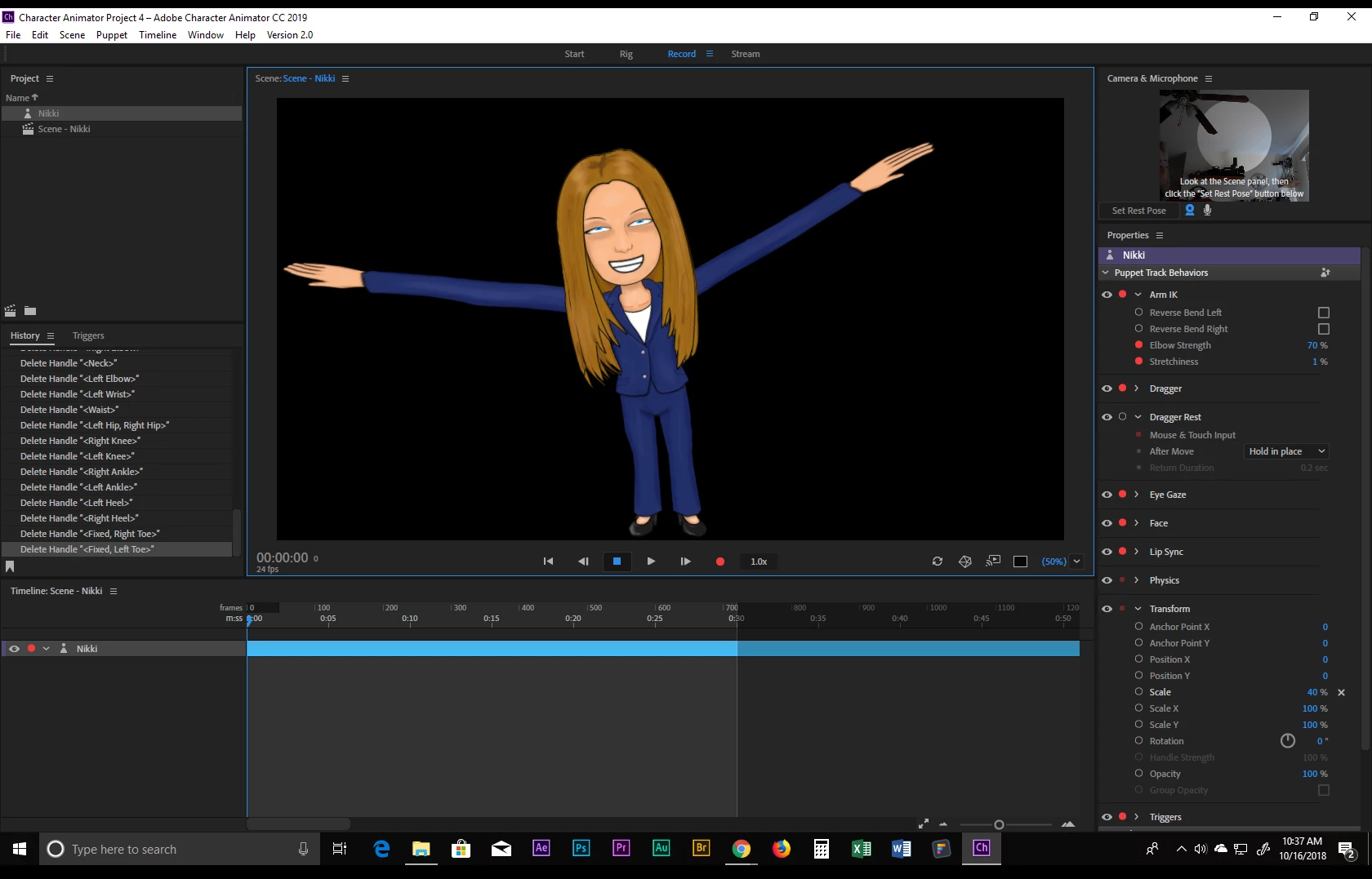

I was so excited about the new Arm IK.  I fallowed Okay Samurai tutorial on YouTube but I keep getting stretchy arms.  I have made sure all button are checked and the stretchiness is down to one.  Can anyone tell me what I am doing wrong?
Thanks for the help.

    Make sure the handle on the wrist is tagged _both_ Draggable and <Right/Left> Wrist (not two separate handles with those tags).

    CoSA_DaveS, thanks for that.... I've been trying to fix this for days

    Thank you so much this is working know.

    Did you get all the shoulder, elbow, and wrist tags connected up? (I have not tried it myself yet - but I assume you need those tags hooked up so it knows what the arms are.)
