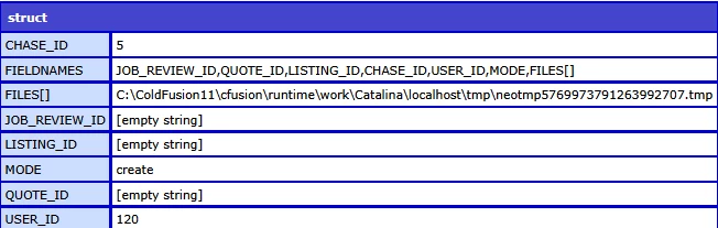

In my local environment, selecting a file produces the following, which is a dump of the form variables used by the function:
LOCAL DEV ENVIRONMENT

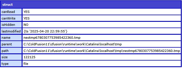

Then BlueImp does its thing via the POST function shown above and the <cfdump var="#fileInfo#"> in the above code returns something like the following:

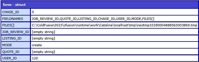

But, after uploading the site to Hostek, the initial file selection produces a similar form variables dump to the local environment, i.e.
REMOTE (LIVE) ENVIRONMENT:
BUT, the <cfdump var="#fileInfo#"> just returns zero (0) in the network tab. There is no dump structure as with the local environment.

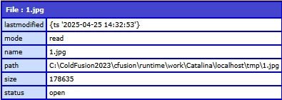

    Aha, just found out I can use fileOpen() in a similar way. This seems to get me what I want:
    Gotcha!
    Thanks for the update. Very interesting test result indeed!
    It confirms my new hypothesis that ColdFusion, in general, and CFCs, in particular, are not necessarily denied access to Tomcat's tmp directory. Rather, it is the call getFileInfo() that is being denied permission.
    Has getFileInfo() been denied read/write permissions in the sandbox, perhaps? I think it's a good idea to ask the server administrator.
    Out of curiosity, did you, for the sake of rigour, use this code:
    fileopen(form['files[]'])

    BUT, the <cfdump var="#fileInfo#"> just returns zero (0).
    By @paul_8809
    Please attach a printscreen of the full dump (similar to the second printscreen above).
    paul_8809Author
    April 21, 2025
    There is no dump at all. Simply a zero (0) showing in the network tab.
