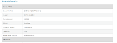

    How do you know ColdFusion is working?
    What is your
    • Operating System?
    • ColdFusion version and update level?
    • web server?
    January 29, 2022
    I'm using coldfusion 2021 version. Operating System is Windows 10. Sorry i don't know the update level.Web server also I don't know how to check that. Please tell me how
    to check the web server.
    My coldfusion application server is working: http://127.0.0.1/CFIDE/administrator/index.cfm. Also I checked Services and see coldfusion applicatipn server is running.
    BKBK
    January 30, 2022
    To get ColdFusion's update level, open the ColdFusion Administrator and click on the (i) at top right.

    To check which web server you are using, run the Web Server Configuration Tool, CF_INSTANCE_DIRECTORY}\runtime\bin\wsconfig.exe. It should show you information about the web server currently in use,
    If you see no information then chances are, you are using the built-in Tomcat web server. However, that customarily uses port 8500. But your URL http://127.0.0.1/CFIDE/administrator/index.cfm
    contains no port number (which may imply port 80). This suggests you're using an external web server such as IIS or Apache. The wsconfig tool should say.
