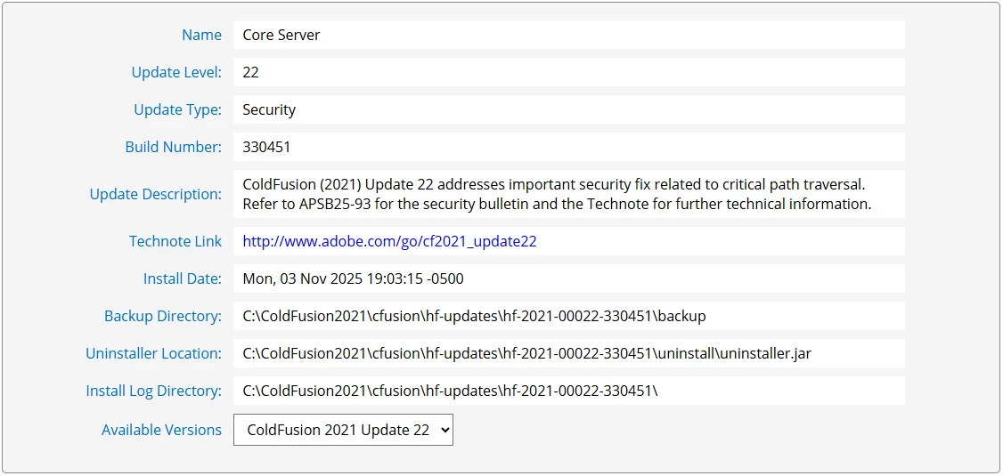

I have inheritted some ColdFusion servers (2021). That has been running great so far but recently, I encountered an odd issue with one of the servers. The issue is that the server stopped processing requests on all instances, whether from websites, APIs, etc. I have tried a number of actions to get this server to start processing requests but all actions have been proven futile at this point.

  5.  Upgrading to the latest available patch (22) on all instances

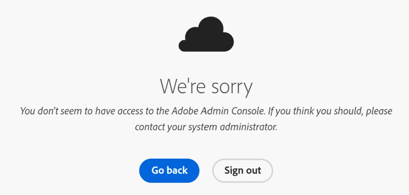

I can't seem to open a case with adobe as I am getting the error below and the admin is no longer available.

    I'm sorry to hear of your challenges. First you have not shown what the error is. Your screenshots show that Cf itself is working, which is a great start. I suspect it's something in your iis configuration. The error message may help us, but perhaps not.
