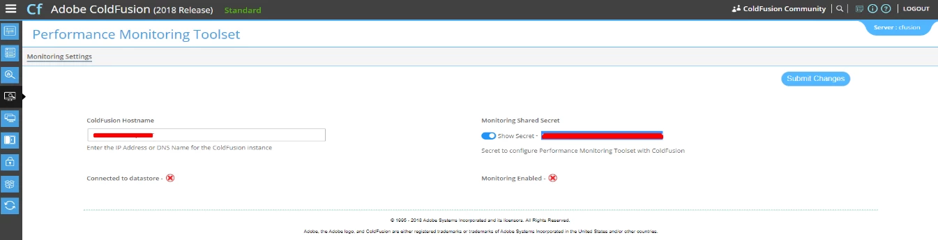

And this is as far as I get
This is the instance I want to monitor
Monitoring is not enabled how can I enable it? Is there some config changes required in the server first to allow detection?
From the documentation (and the options available in the Server Administration UI) I can't see any option.

    Finally, as for that page in the cf admin, it merely confirms IF a pmt (anywhere) is monitoring that instance. It's one way, passive. You don't use it to POINT to a pmt, or to ENABLE that instance to BE monitored by one.
