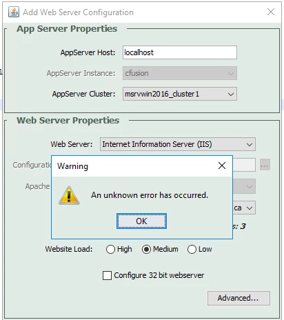

So, I have two server: msrvwin2016 and msrvwin2016-02.
I have 2 instances on each (cfusion and msrvwin2016instance1 / msrvwin201602instance1).
I created a cluster on the cfusion instance on msrvwin2016 with msrvwin2016instance1 and the remote instance msrvwin201602instance1
When i try to link IIS and CF with this cluster selected, i have an error "An unknown error has occured".
I don't have this issue with the first release of CF2018, but since the "Update 2", it doesn't work. I don't find any logs where there is more detailed informations
Weirdly, it works when I select one instance and not the cluster in the Web Server Configuration Tool
and when I select the cluster and there is no Remote Instance in the cluster.
So the problem seems to be the remote instance, but the configuration looks ok and it worked before Update 2.
Does any one had the same problem or knows what to do?

Few screenshots:
When making the configuration with a cluster:

EDIT:
I did the test again:
On CF2018, with no update.
1) I create my remote instance
2) I create my cluster
3) I add my local and remote instance to the cluster
4) I launch the "Web Server Configuration Tools", I select my cluster and my website, and it works
On CF2018, Update 1:
1) I install the update
2) I launch the "Web Server Configuration Tools" and delete the configuration from before
3) I add again the connection between my cluster and my website, and it works
On CF2018, Update 2:
3) I add again the connection between my cluster and my website, and it fails wih the "An unknown error has occured". It creates the folder in wsconfig with only the isapi_redirect.dll, it also create the virtual directories in IIS (cf_scripts and jakarta).
But there'sno logs in coldfusion, wsconfig, event viewer...nothing.
So i'm lost...
I've made a zip files with my configurations and screenshots, if somebody has time...
https://drive.google.com/file/d/1pglrTAn6eBPK-ibJuXf1svF5wCSvPm1e/view?usp=sharing
Thanks

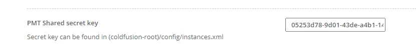

Community Beginner , Aug 08, 2020 Aug 08, 2020
Hi Chalie,
Thanks again for the time you took to look at my problem, i appreciate it.
I've talked to Adobe support and the issue was that i didn't filled the "PMT Shared secret key" when creating the remote instance which is required since update 2 (even if the field is not marked as mandatory)
Now, it's working fine !

Hi Chalie,
