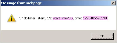

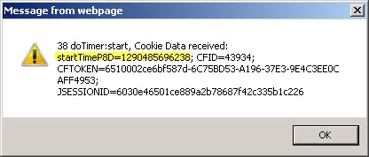

So I put together the procedures to store the "start time" (startTimeP8D) for the transition and activated it on the onUnload event of a 1stpage.  After a few rewrites I got it working.   Here is the JavaScript to do that: it consists of two functions: doTimer which is the input section and setCookie, which writes to the cookie.  Not the two numbered alert statements.
doTimer - results for "start" from the doTimer function called from page 1 when it unloads. (See doTimer below)
     Please note that the two startTime8D values are the same immediately after they are stored.

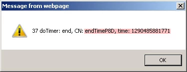

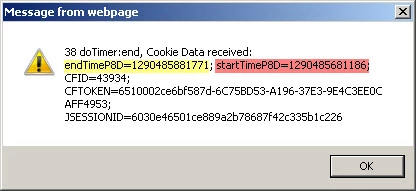

On the 2nd page in the sequence, I run the corresponding code to determine the "end time", compute the delta and write it out to the page.  It didn't all run on the first try, but it now seems to be running without a crash, which can be misleading.
      second set of outputs from page 2:
     Please not that while the endTimeP8D match, the startTimeP8D value no longer matches the previously stored value.
There is one major hitch in the get along which has me stymied:  As you can see, when you compare the startTimeP8 in the setCookie – results above and the "startTimeP8" in the doTimer results below the startTimeP8 is not the value that I wrote to the cookie @ unload of page 1.  I have checked and checked and do now see anywhere that the startTimeP8D value is being overwritten.  Based upon my limited experience with JavaScript cookies, it seems to me that you get an entry for each time you set the cookie.  So I would expect to see to startTimeP8D entry for each setCookie event, not a different value.
