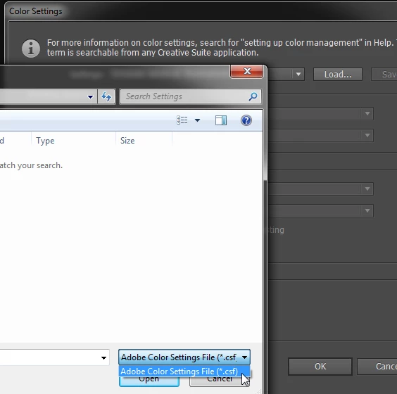

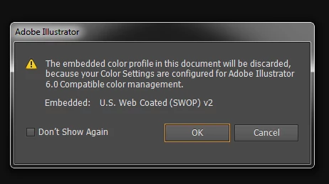

Hello. I am using Adobe AI CS6 and am trying to open a file that has used U.S. Web Coated (SWOP) v2 and since for some reason I don't have that, it wants to convert to AI 6.0 Compatible which I do have. So after some searching, I was able to find what i thought was the solution--ICC profiles which includes what I need (http://www.adobe.com/support/downloads/product.jsp?product=62&platform=Windows). However upon going to Edit>Color Settings>Load, it only accepts .csf files but what I found are .icc files. Obviously I have no idea what I'm doing here and just need to open this file properly. Any insight from someone that is actually knowledgable on this stuff? I appreciate it!! Thank you. [EDIT: I assume the solution would be to find the .csf version of U.S. Web Coated (SWOP) v2 instead of the .icc but I am unable to find those? Or I am going about this all wrong.]

    A color settings file *.csf contains references to existing ICC profiles and other
    parameters like here - altogether a configuration:
    During the configuration it's a Custom setting. Then it should be saved by an
    understandable name. Afterwards It can be loaded by this name, as above.
    Best regards --Gernot Hoffmann

    Go down to Color Management Policies and choose "Preserve Embedded Profiles". Then the document will open using US web coated SWOP, since that's the embedded profile.
    The .csf color settings file is just a preset of choices for working spaces/icc profiles. You can choose whatever you like and save that as a new preset.
