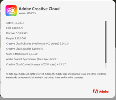

Which exact version of the Cloud desktop app are you running?
Community Beginner ,
Jun 19, 2023 Jun 19, 2023
5.10.0.0573

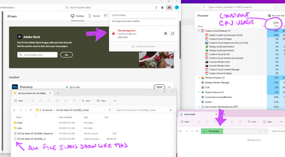

@kglad thanks for your response, and for your help, here is what I did:
- I closed everything and restarted my computer
- then I restarted Adobe Cloud Ctrl+Alt+R, as directed
here is what what happened:
File sync stopped working,
I get a File Error - Could not enable sync,
- I paused and resumed the syncing - didnt work
- I clicked the refresh button - still the same
also here is a screen shot,
- I still have a constant 20+% cpu usage
- all file icons inside adobe cloud sync folder are white
- some folders inside adobe cloud sync folder wont open
- other folders show that green loading bar forever
-other folders never show contents, that also happens with my default downloads folder as shown in screenshot.

I found out the issue was caused by a premiere project, I was just starting my monthly backup, and as soon as I moved the first project folder to archive and deleted it from adobe cloud, everthing started to work normally again.
This is not the first time Ive seen sync issues related to premiere projects, the difference is that in the past I would get an error message about a file that couldn't be synchronized. most of  the times it was either .pek or .cfa file that premiere pro generates by itself. I remember reporting this more than once, I even mentioned it  in a phone call with tech support.
Well this time I got no error message and no way to know what was causing ac to freeze my computer.
I hope this is helpful.
