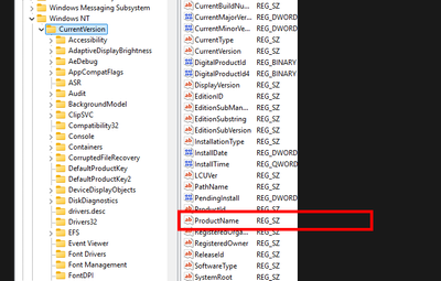

This is Windows 11. If you don't believe, go to C:\Windows\System32 of your Windows 11 PC and right click on any system files to see it's version, they are all 10.0.2xxxx. If it's Windows 10, it would be 10.0.1xxxx.
Jun 25, 2025 Jun 25, 2025
your error message shows win 10
Explorer ,
Jun 26, 2025 Jun 26, 2025
I have explained already, the error message means it's Win 11, as the version is 10.0.2xxxx.
I'm a software engineer and familiar with Windows. You can check https://en.wikipedia.org/wiki/Windows_11_version_history#:~:text=It%20carries%20the%20build%20number... to understand Windows 11 version.
The BSOD happened for the 4th time and it's similar to the 2nd crash (node.exe). So far all crashes root back to creative cloud.
I'm going to disable creative cloud, and if the issue would not happend, it probably means it is Creative Cloud that is broken.
OSNAME:  Windows 10
is win 11?
Explorer ,

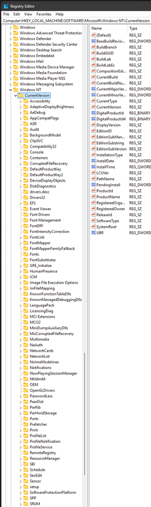

Yes, exactly, Windows 11 is basicly Windows 10 with UI and other changes, the system version is still Windows 10.
If you don't believe, check your Windows 11 PC, open regedit, and check the value under HKEY_LOCAL_MACHINE\Software\Microsoft\Windows NT\CurrentVersion\ProductName, you will find your Windows 11 is actually Windows 10.
i don't have a ProductName key under  HKEY_LOCAL_MACHINE\Software\Microsoft\Windows NT\CurrentVersion
did you upgrade your win 10 to win 11?
Explorer ,
It's weired that you don't have it, and I actually suspect you may check it wrong (e.g., checked HKEY_CURRENT_USER, or Windows, not WIndows NT). I have checked 5 Windows 11 PC so far, personal PC, PC from company, and latest Surface Pro (ARM) which only supports Windows 11, and all of them shows Windows 10 as the ProductName in registry, with different suffix (Home, Pro, Enterprise, etc.).

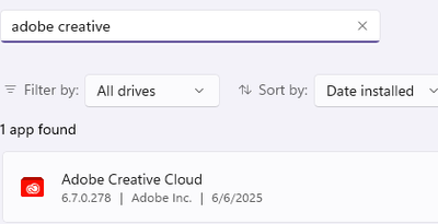

Hi Tarun! My Creative Cloud version is 6.7.0.278, and I'm currently running Windows 11 Pro (though I just upgraded from Home) 24H2, build 26100.4652.
