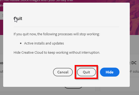

You can shut the Creative Cloud app down and also stop it from starting with the system.
To di that you open the CC DTA preferences by clicking the Gear icon in the upper right of the window.
And shut down the Auto Update option.
And also these options.
And finally when you have done all that shut the CC DTA down.

Thanks, but thats not solving my problem. Im a graphic designer and using the CC apps almost all day. And before upgrading to catalina it wasnt a problem.
