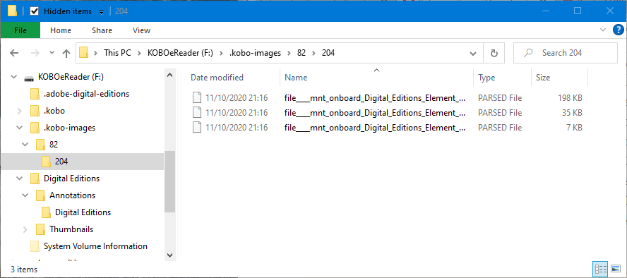

I have been tearing my hair (what hair?) out for literally hours on this: I did not fully read the above response (I was getting fed up), but had a look (with W10 file explorer) at the file structure on the Kobo when plugged in, and found a load of adobe-related folders with numerical names, and what looked like Adobe ID codes inside. I deleted all ot these, and maybe other ones as well (they are now gone, and I didn't think to screen shot the contents before deletion - after all, nothing else so far had worked, so why should this?). I then started ADE on the PC, authorised it, then inserted the Kobo and authorised that, then copied a 'new' book across - and it worked. I went to bed, hapily reading a book I am fairly sure I read years ago (on paper) - oh well.
I shall attempt to upload an image of the current folder structure - it doesn't seem to conatin the same stuff that I deleted, but gives an idea.
If in doubt, delete every folder on the Kobo that is ADE-related! If this ever happens again, I wil attempt to show what needs to be deleted more carefully. For now I am happy.
PS This is certainly a Kobo issue, and they should fix it. One can hardly expect Adobe to know what the Kobo stores inside itself. They (Kobo) must have discovered the cure that I found, surely?
Good luck, Martin
