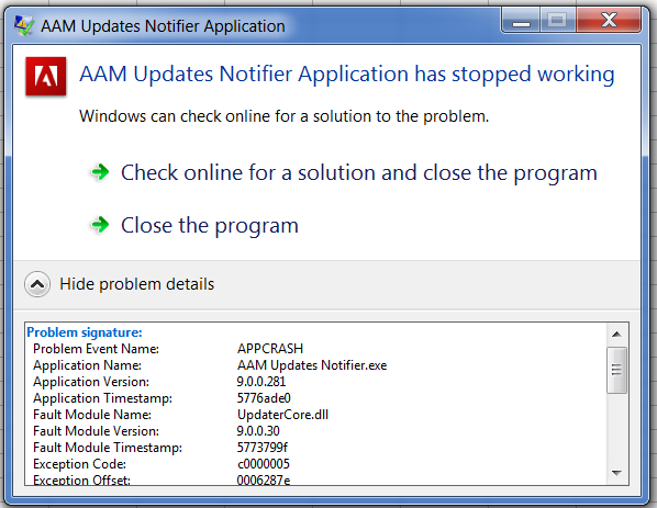

Here's the usual CC error notice and below that a new error today.

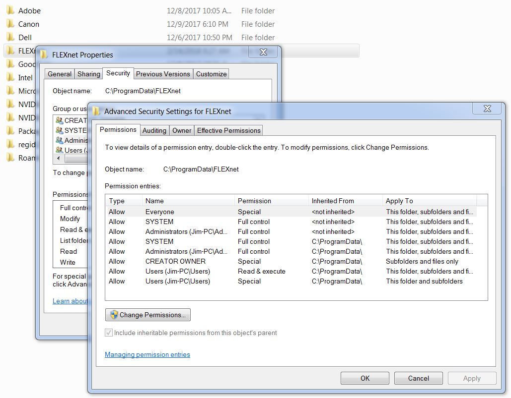

Jim, the solutions listed in Error: "Licensing has stopped working" | Windows do lead to a resolution of the error.  Did you implement Solution 4 which discusses updating the file permissions for the FLEXnet folder?
I am unsure why the current installation of CS3 became damaged, Jim.  As a next step, you could try creating a new local administrator account.  This would resolve any permission issues with the FLEXnet folder.  It may also resolve several of the errors you are facing when attempting to open Photoshop CS3 or Acrobat 8.  Information on how to set up a new local administrator account can be found at https://support.microsoft.com/en-us/help/13951/windows-create-user-account .

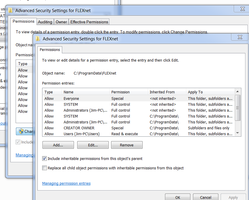

I resumed the 9 step plan. Moved to Solution 4 this morning and got lost on step 16-17. I tried to find my way through as I realize details change from time to time, but nothing matches up from this point. There is no "edit" button on the permissions tab, only a change permissions button, and if I go there I never see the "Replace Permission Entries On All Child Objects With Entries Shown Here That Apply To Child Objects option" mentioned in step 18. Simply applying/closing what I had done up to then did not fix the problem. Solutions 5 & 6... I have no such C:/Program Files/Common FIles/Adobe PCD folder or anything with PCD nor under (x86). So I took your advice and created a new administrator account and PS still did not run. So I tried Solutions 1-4 on it and no difference, same missing buttons and folders and same result. [note in my scree captures below that the system, administrators and users accounts are each listed twice with different "Inherited From". Any significance?]

Jeff or anyone,
What do you make of "I have no such C:/Program Files/Common FIles/Adobe PCD folder or anything with PCD nor under (x86)."
or

Jim, make sure you are able to view hidden files and folders.  If you are not seeing the necessary folders, but CS3 is installed, then it is because they are hidden.  Details on how to make hidden folders and files visible can be found at https://support.microsoft.com/en-us/help/14201/windows-show-hidden-files​.

Yes, Hidden and system files are both visible.
I looked harder and found a PDC folder under C:/Program Files (x86)/Common FIles/Adobe/Adobe PCD
So I went the the reset permissions steps on it to no avail. Note again that the instructions diverged from what I found and I could not really tell that I was close to doing what was asked.
I also tried solution 6 now that I could locate the folder and deleted cache.db (no cache.db-journal) under C:/Program Files (x86)/Common FIles/Adobe/Adobe PCD/cache.  No help.
